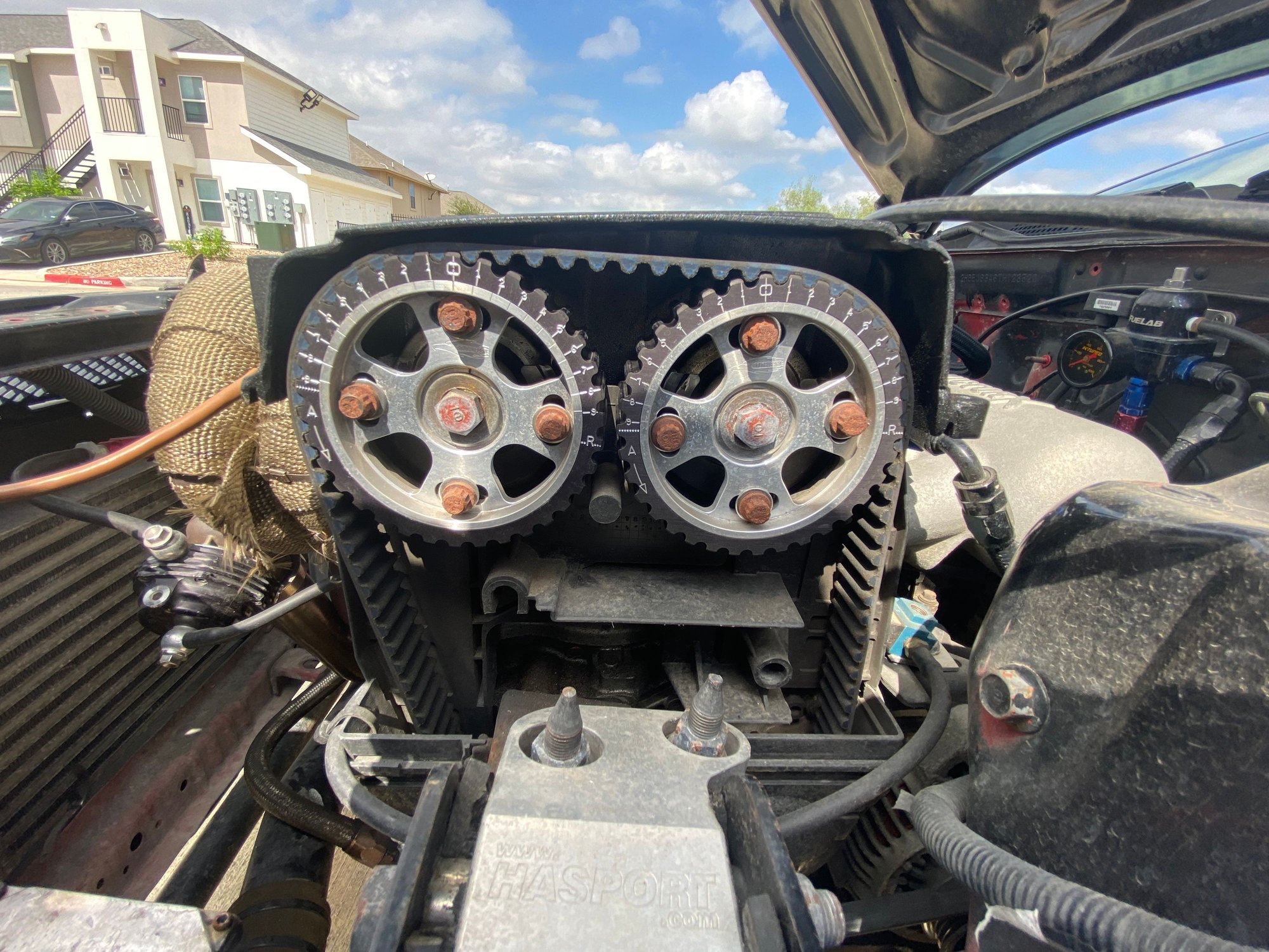

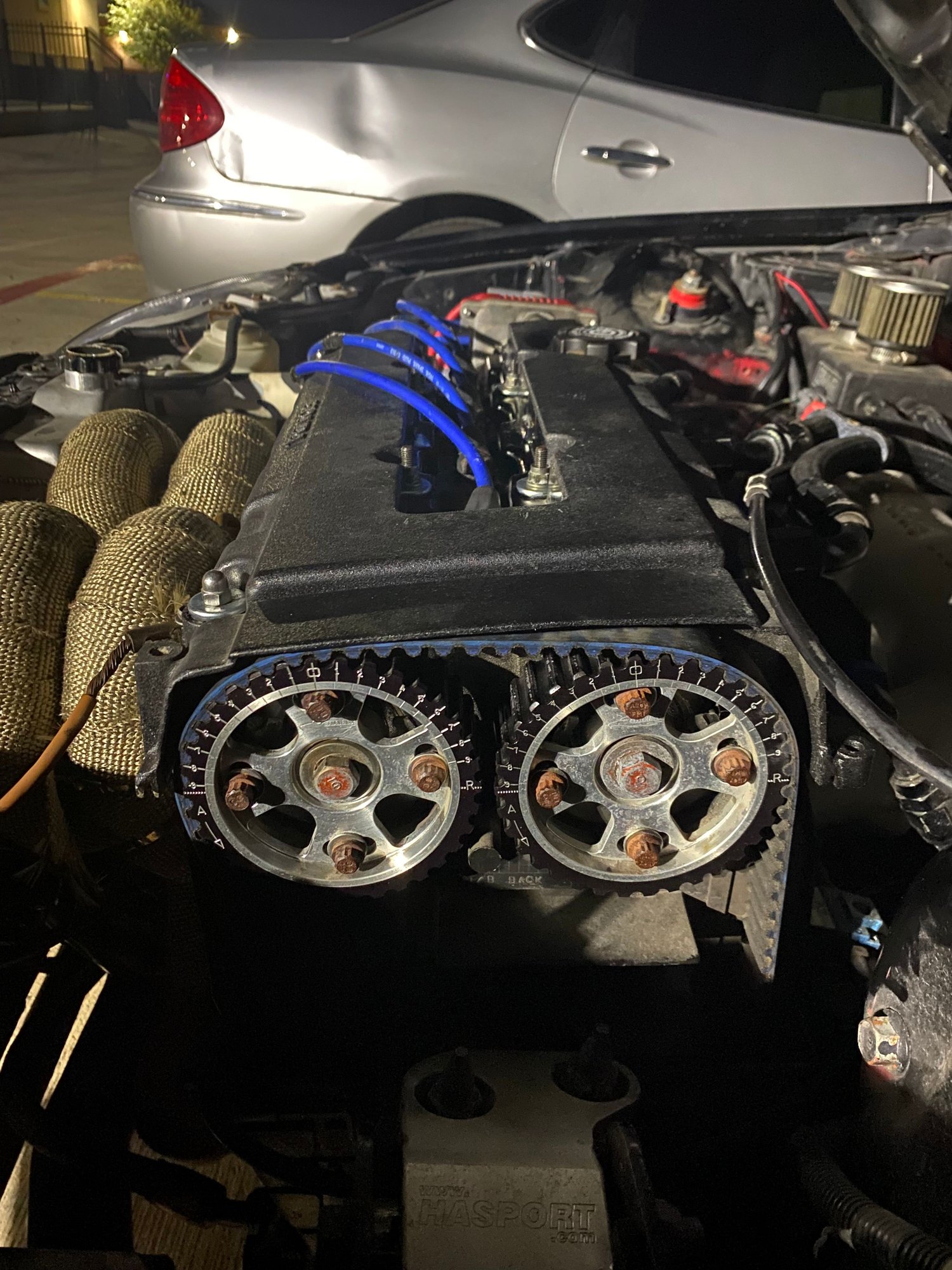

Hello everyone, I've encountered a dilemma that I'm not sure how to approach. I recently acquired a 96 civic hatch with a built ls/vtec engine set up. Car ran fine for the first ~2k miles of my owning it (sorta babying it as I get to know the car). Anyhow, I was working on the car and re assessing the bushings on the motor/trans mounts as I was having a little more wheel hop than usual. Car was running/idling and I went in to shake the engine with my hands and my idiot self grabbed where the cam gears are and my middle finger was hacked up nasty (its fine now lol). The car sputtered and died soon after the incident.
Now ever since then, when I start the car it idles funny. It sort of bogs at a lower RPM (like 500-700ish) than usual (which would jump from 1-1.3k until it warmed up and settled at about 900-1k or so) and I had to give it some gas to keep it from dying while idling. I turned it off and haven't started it since. This is not like it used to idle (which wasn't great but once it warmed up it evened out).

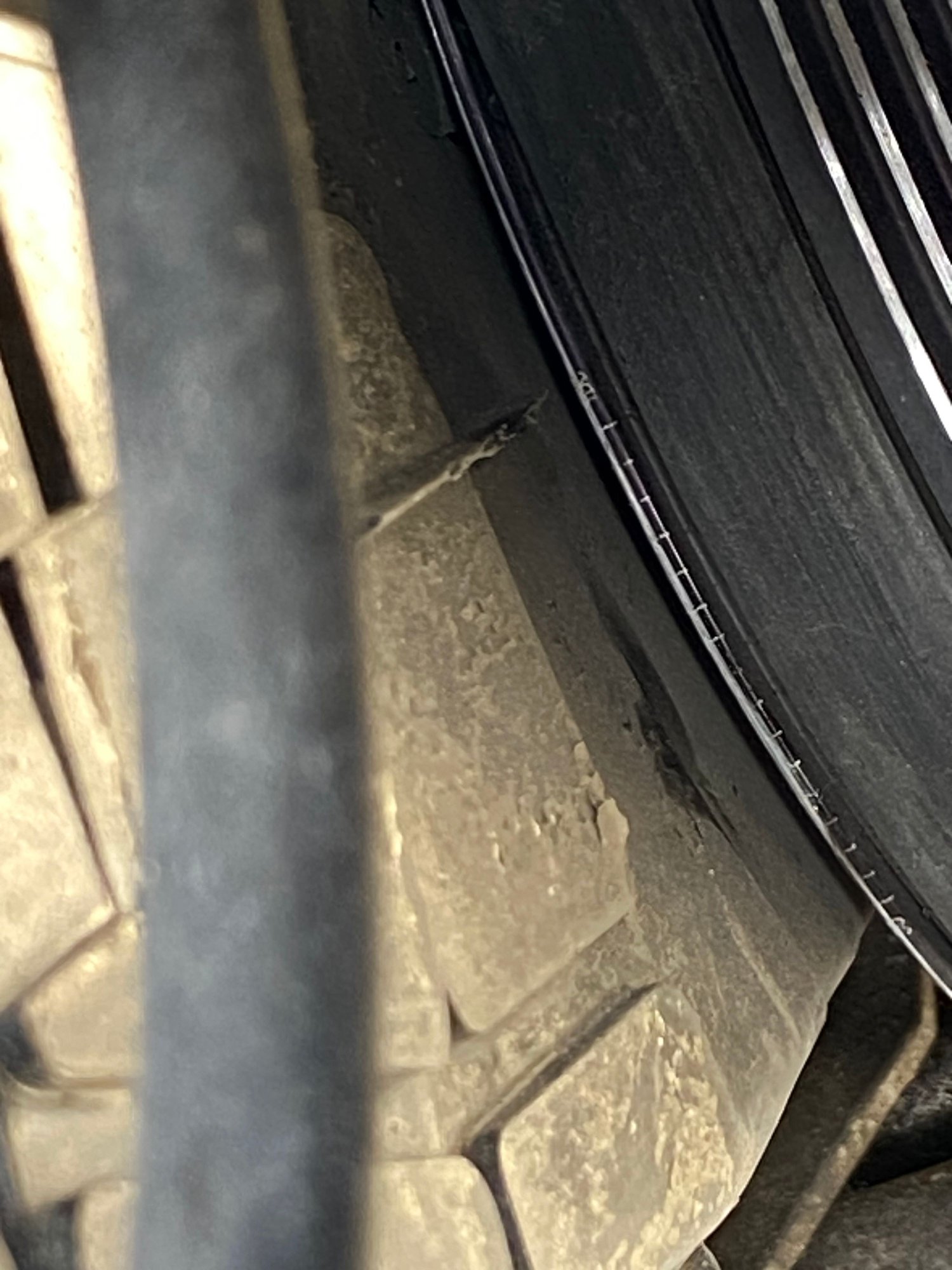

The car has an ATI damper installed and I put it to TDC at the crank (with the pulley still on, and following the mark on the pulley/plastic cover as noted below). The Golden Eagle cam gears appear to be off a bit, maybe a tooth at the exhaust side. The thing is I have never taken a picture of the cam gears at crank TDC before so I am not sure if this is how it was before (the car had been extensively tuned before). That being said this is my first turbo honda, so my general Honda knowledge is low, specifically mechanical timing things. I've perused the forums a bit and I've got a general grasp on what I need to do next, but I wanted to go ahead and post this and see if anyone has any other input. Thanks everyone for reading ~

Your engine is currently out of mechanical time and this is why it runs poorly. It was fine... and now it's not. Get it back in time and all will be back to normal.

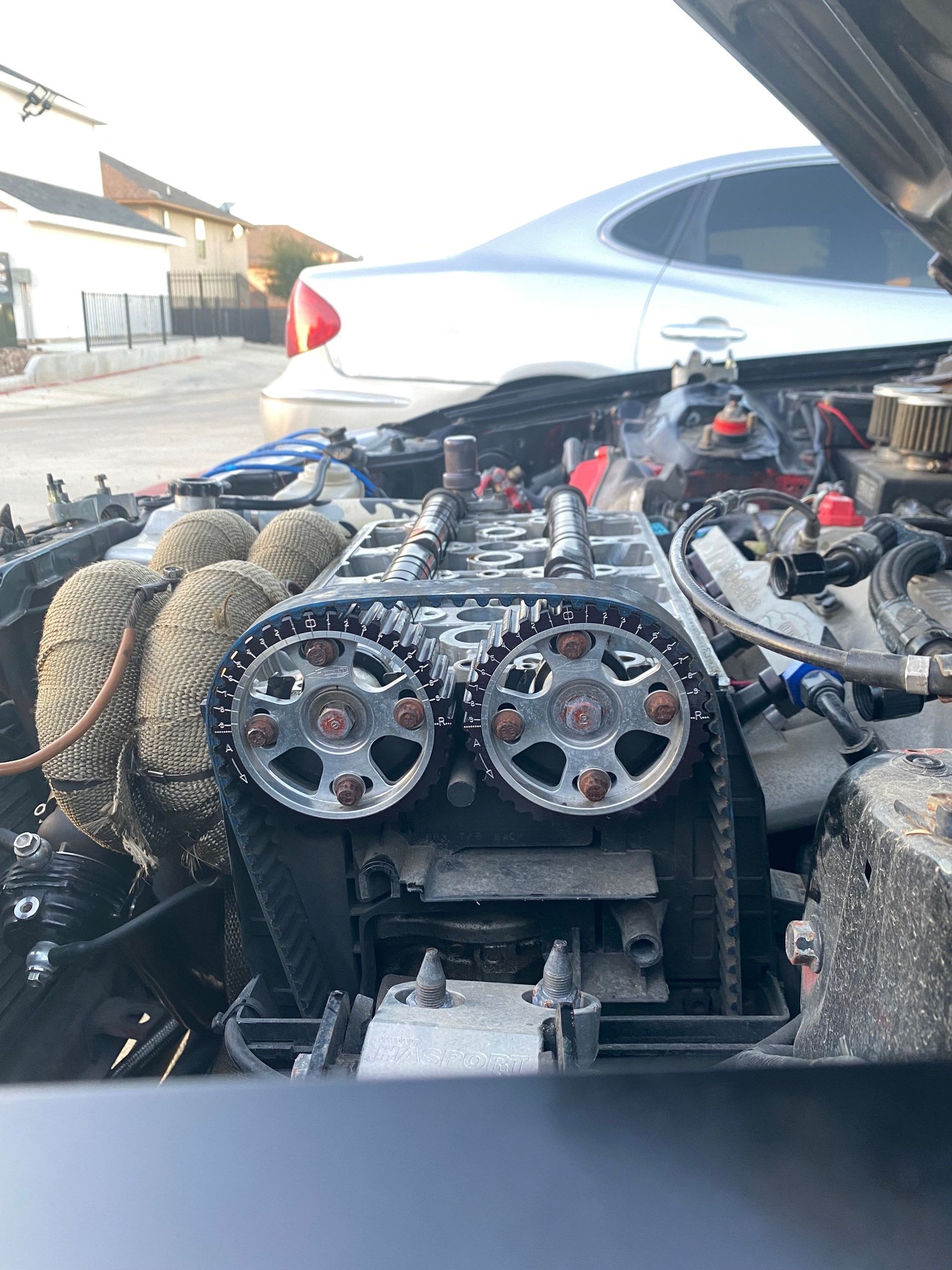

I wouldn't take anything more than necessary apart unless you have to... a long screwdriver in the #1 spark plug hole will give you all of the proof you need to verify that the crankshaft is at TDC. I personally wouldn't even loosen the tensioner... I would "Tip" the offending camshaft out/down and rotate it slightly, set it back down in the journals, and then re-torque the cam caps/rails.

Alright so this was the best I was able to get it after rotating the exhaust camshaft 1 tooth "advanced" i.e counter clockwise using the method @JRCivic1 suggested. Looks much better, but it isn't perfect as you can see. Pending the new gasket/RTV to cure, I'll see how it runs tomorrow. Everything was torqued to spec including the valve cover bolts so it should be tight. Used RTV/honda bond equivalent where needed on the cam caps. Hopefully this fixes the funny idle.

The car idles much better now. Does its usual **** as it warms up and RPMs jump up and down a few hundred then finally settles once its really nice and warmed up.
