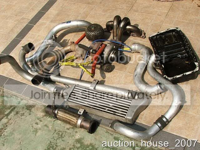

Dont know where to run the lines coming out of my turbo. I got the oil lines covered. But see the blue vacuum line coming out of turbo, does this go to map sensor? and also the two thick yellow lines, do they go to a manual boost controller or what? and if so how will i know which line is air out and which one is air in? thanks

If that's a ball bearing turbo the yellow lines coming off of the turbo are coolant lines. You will need to provide a supply and return from your engine. The blue small line seems to be coming off of the compressor housing of your turbo which would hook up to some sort of boost controller; whatever it is you decide to install.

it is a ball bearing turbo, thanks. its a garrret gt2510, where would you suggest running these coolant lines to? and also would you say i should run the wastgate open atmosphere or tie into the vacuum system somewhere? i have a blox vacuum manifold if that helps and this is also going on a b16a

the blue line should go to your wastegate, and yes the yellow lines are for coolant-you can run these into your heater hoses.

is this true for internally wastegated turbos as well? asking because turbo was used and the blue line is awfully long to just run it straight over to wastegate. like probaly 8 times longer than it would need to be to just run over to the wastgate. i can take pics of my install process if need be

IDEALLY the blue line would operate the wastegate, but whoever was using it before probably was using it for a boost gauge, OR, had it going to a boost controller then from the boost controller running back to the wastegate.

Since nobody mentioned what does go to the MAP sensor, I will: the MAP sensor must be plumbed to the intake manifold downstream of the throttle body.
