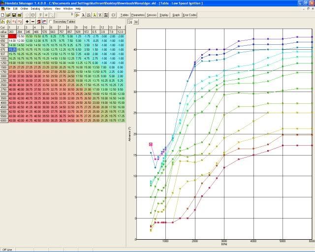

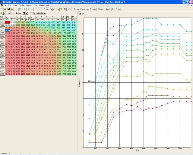

My next issus is when I am at around 4500-5500 rpm the car will start to hesitate and not want to move smoothly. The car will bog down and jerk a bit but as soon as you give it a bit more gas it clears up, now I dont hear any backfire or anything like that and I have changed the plugs thinking it is a plug issue but same thing.
I would like for some tuners to take a look at my graphs and tables to see perhaps maybe there is something I can change or have him take a look at after I get the headgasket issue cleared out.

Low Ignition

post your ignition maps. from the looks of it, your tuner didnt tune your part throttle maps very well. u have higher load cells with less fuel than some of your lower load cells. i would get the part throttle maps retuned.
what gap on the spark plugs are you running? also how big is your exhaust? we need to see your timing map to help you out

I put the timing maps up and also as far as the exhaust the dp is 3in and everything back is 3in and it has a 3in high flow magnaflow cat as well.
Spark Plug gap is .28 as well

you sure the car was detonating? stock GSR pistons right? Your timing looks way retarded in the VTEC map and u can see it on the dyno graphs too (graph is choppy and not smooth)
i would pull out the cat and run a 3" pipe in its place. did the tuner pull the plugs to see if there was signs of detonation?

that tune is ALL OVER the place. where is your vtec activation? with your combo, vtec is going to want to be at a really high rpm.

how much timing did he start off tuning the car with? choppy lines on the dyno graph can mean several things - exhaust restriction, too little timing and ofcourse detonation. i dont see how your car can be detonating with such low timing. i think u should bring it back to the dyno and start adding timing to ur VTEC map 2* at a time and see how the HP changes. keep doing so until you stop making power. also check the plugs with every pull to check the burn.

to low of timing caused my car to do this. if its detonation the plugs will look like they have pepper on them. do a 3rd gear pull your self shut the car off as soon as you hit the spot the tuner says it detonating at pull to the side of the road and look at your plug. i am trying to start a plug reading thread here is the link maybe it can help or you can post your plugs on there

the lines crosses
the lines are not equal.
the map isnt really smooth, lots of big jumps.
i would try another tuner personally
