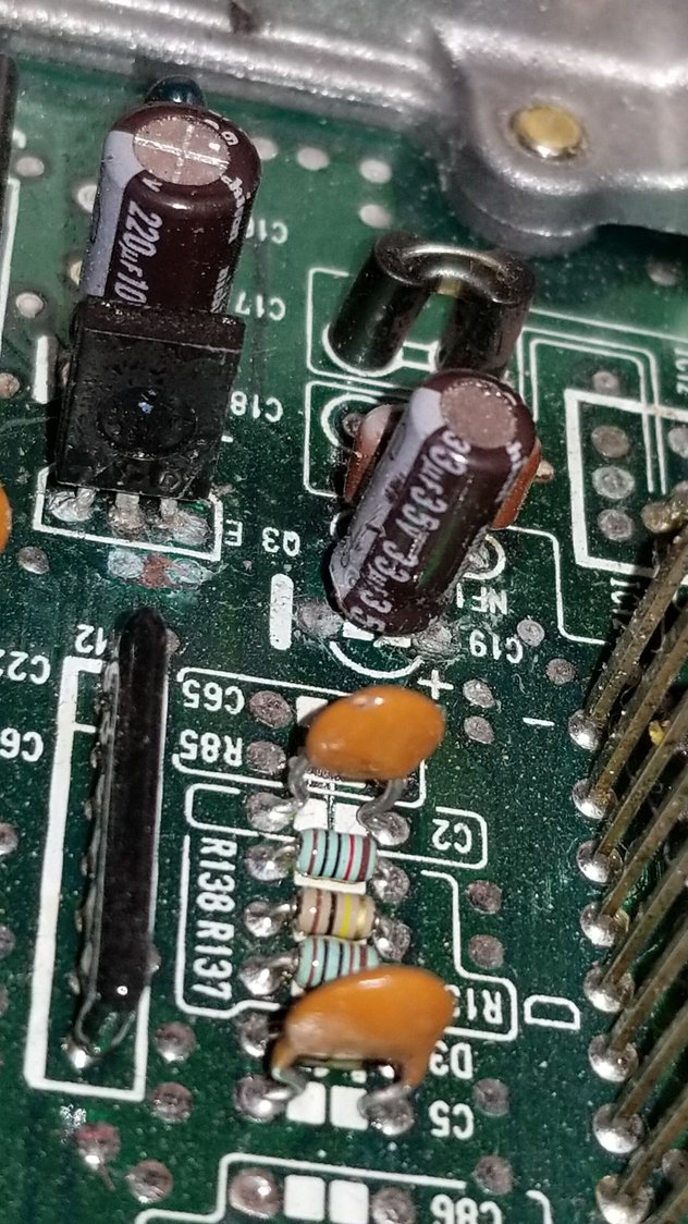

sounds like it running crome or chipped basemap. you need a true EMS ie. Hondata, neptune AEM ect,
crome used a system where you could "burn" a tune to a chip, which you rarely see anymore since the other EMS systems mentioned are much better. Sounds like you need to get a proper EMS and take it to a professional tuner. You may want to start off by contacting R12 and see if they have additional info for you or possibly take it back to them since they may have a better idea of how it was tuned
Your ecu may have had a component failure, you said its cracked pics would be helpful

Posts: 13

🔼🔼🔼 what they said. If you have a graphing meter (doesn't everyone), or know how to test everything without one. There is only one thing left. Ecu. Whoever built yours, can probably test it, or mail it off to have it done. Resistors do swell and crack when they go bad. I keep thinking it is temperature related.

may not even be a resistor I was thinking transistor those crack but not due to temperature most the time usually they just fail or have improper voltage flowing through them. (this is just a guess, I wasnt able to pull anything up with the numbers provided need to see pics) since its cracked you dont even need a "graphing meter" just replace it assuming everything else in the ECU is in working order, usually when one component fails there is a reason for it and other things either get damaged or already are damaged and caused the secondary component failure.
I was more curious about the tune anyway, honestly if it was me I would get a hondata based ECU double check the things shodan mentioned and have it retuned, before the motor explodes

Posts: 13
Default Re: Troubleshooting: Boosted Ls/Vtec goes all to pieces over night
Posted pictures earlier ....but said want be visible till approved

I would not repair that ECU theirs just too much damage, Get a p28 with Hondata pre-installed. I found that B&R fittings had the best prices but you can also get it from Xenocron or others.

Does look like that ecu has a problem. Hopefully there is no cause that has not been fixed. It would be interesting to see what your outputs read like on a graphing meter. In my opinion, it is the best way to damn one. Too many times I see people replacing computers that don't need one. Are your injectors hanging open? idle air duty cycle? What is your coil, and signal doing? You say your intake is hot. Timing belt alignment? What's your ignition timing look like when you use a light? Just throwing stuff out there. Blowing a bunch of dough on hondata, and plugging it in when you don't know for absolute certain would not be a wise thing I do believe. Probability is high that it's toast, but we are also talking about damming something that hasn't been tested either.

ECU looks toast.
