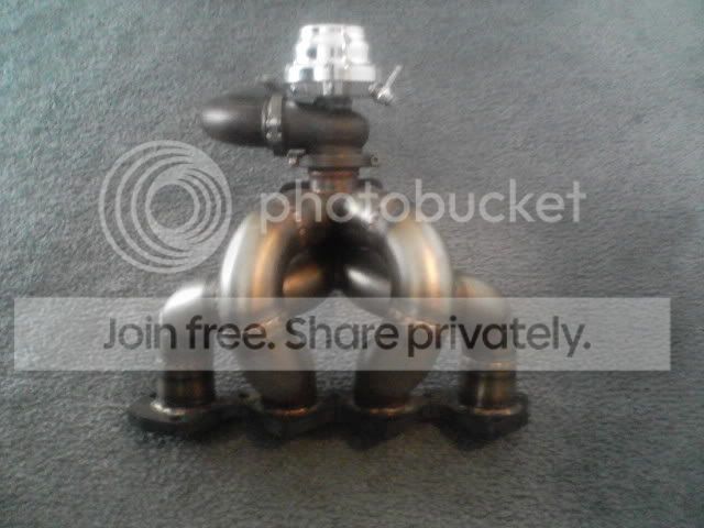

what would be the average height of a top mount? Does is vary from desing?
I have one but it seems shorter compared to others , but I never seen a top mount in real life, so then again i don't know.

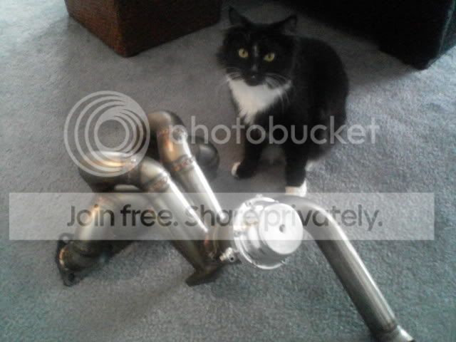

all I can say is have fun with that wastegate placement… looks like you might run into boost creep issues .... but other than that it looks fine, who made that manifold?

Old Feb 16, 2007 | 07:32 PM
turbo_ls_69's Avatar
Posts: 378
the wastegate only comes off that one runner?

<TABLE WIDTH="90%" CELLSPACING=0 CELLPADDING=0 ALIGN=CENTER><TR><TD>Quote, originally posted by turbo_ls_69 &raquo;</TD></TR><TR><TD CLASS="quote">the wastegate only comes off that one runner?</TD></TR></TABLE>
put down the pipe
it comes off of the two runners where most do
Looks to me that someone else put a couple of extra bends from where it was originally.

Default Re: top mount question (AViciousTHRUST)
WG placement sucks...think about the way the exhaust gasses have to go now to get to the WG......i smell boost creep issues in the future...
I'd plan on changing the wg placement on that one now, before it goes in the car. If you have a decent sized turbo and exhaust, i think it's going to boost creep pretty bad.

Default Re: top mount question (tony1)
but why would the placement of the wastegate like that, cause boost creep issues?
<TABLE WIDTH="90%" CELLSPACING=0 CELLPADDING=0 ALIGN=CENTER><TR><TD>Quote, originally posted by AViciousTHRUST &raquo;</TD></TR><TR><TD CLASS="quote">but why would the placement of the wastegate like that, cause boost creep issues?</TD></TR></TABLE>
its pretty simple...... think of the way your exhaust is flowing. when you try to make it do a complete 180 and then travel that far before getting to the wastegate, that is where you are going to have boost creep. If you notice on most manifolds they don’t have wastegate placements that make that many turns and they aren’t that long……
never had any boost creep issues with that kind of wastegate placement on any of our other manifolds.
same manifold design used on spoolinmatts 690whp motor, 19sec beasts 630whp turbo LS, spoolinmatts 630whp turbo eg
if you want AC and PS, somethings gotta give

Default Re: top mount question (VtecKiDD)
<TABLE WIDTH="90%" CELLSPACING=0 CELLPADDING=0 ALIGN=CENTER><TR><TD>Quote, originally posted by VtecKiDD &raquo;</TD></TR><TR><TD CLASS="quote">never had any boost creep issues with that kind of wastegate placement on any of our other manifolds.</TD></TR></TABLE>
that is no where near the same wastegate placement as the OP's
