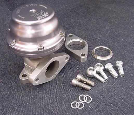

What is the ring for, that comes with the kit?

that ring is the valve seat it seatsthe wg to the flange.

Opps, I didn't install that when I mounted the wastegate to the manifold...
I'll do that tonight.
But it doesn't fit in there flush. I have to apply pressure to the sping in-order to get it to mound flush on the flange.

you have to install that for air tight seal or you wont be boosting nayhting...

I remember that ring. It aligns the connection dead center and clings to the flange so you wont have any leaks.
I wish I can use a ring like that on all my exhaust connections.

So, does the little lip go inside the Tial? or does the little lip mount into the manifold?

lip goes inside you should have a true flat service on the wg moutning side

I get it.

just make sure when you install it, that it's flush and there is no gap between wastegate and manifold... i made that mistake and the w/g was venting at idle, lol.

I add the gasket right? That should seal any leaks, right?

you talking about the paper gasket it will probably blow it couple days.. its peice of **** gasket.. but really dont need it if you surface is true and clean.

ok, no gasket then.

I was wondering about the gasket myself. I might buy the Tial wastegate used and the guy said he didn't use the gasket, silicon instead. should I buy that or does it sound fishy?

just pickup a turbonetics gasket, they have a metal ring on the inner part and that will solve the wastegate gasket blowing problems.
