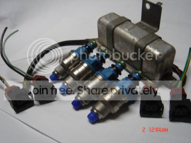

they look more like DSM injectors.... I have presicions and mine look nothing like that

yes those are DSM 450's here is a pic of some simuler to those you have

They are DSM 450CC injectors
They will plug directly into your injector clips.
U will need a resistor box.

I dont know what they say on the side but I am 100% sure those are DSM's that you have. Yes you will need to run a resistor box with them. and they will plug right into a OBD1 wire harness

go to a junkyard and look for a CRX and most of them have resistor boxes. They are pretty cheap. you could also look on Egay for one....
What kind of car did you friend have?
the only injectors that you wont need a resistor box for is going to be a saturated injector. Look for RC's I am not sure if Precision makes saturated or not (I could be wrong though)
