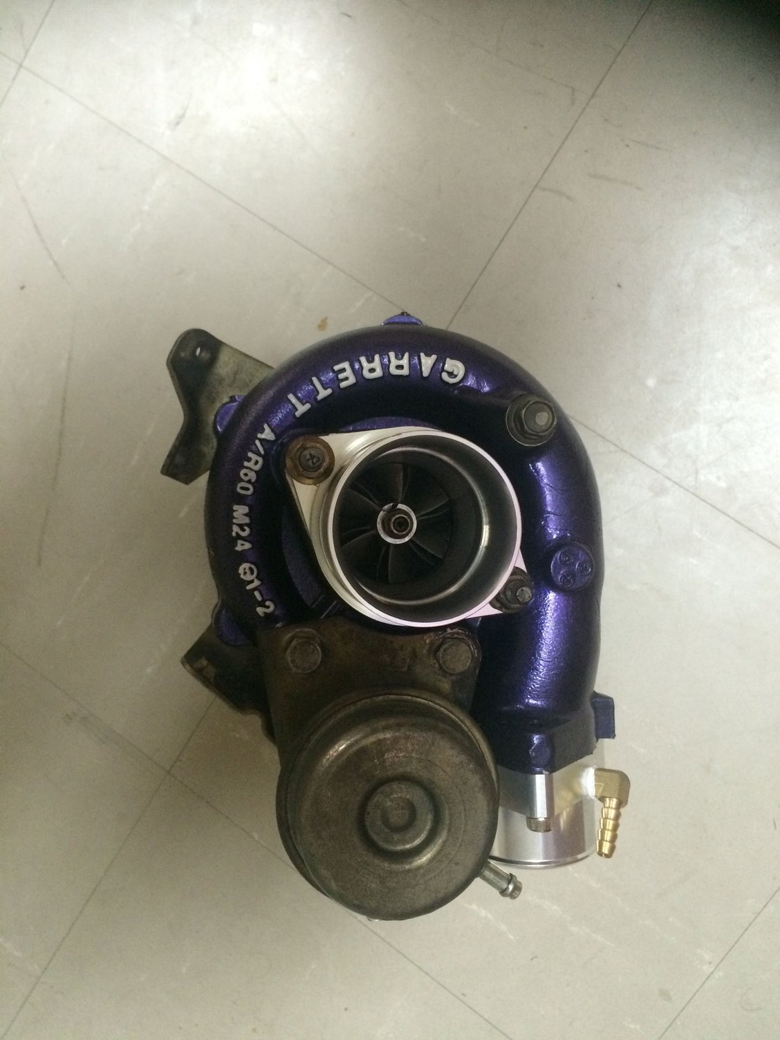

Also here is the turbo if you can further identify it

I need the numbers off the tag on the CHRA to be able to determine what it is. Also a photo of the turbine outlet would help.
[IMG]https://cimg4.ibsrv.net/gimg/honda-tech.com-vbulletin/2000x1504/80-
image_90372be5cdce9cf2cb72eb18373423ecbac91ed7.jpe g[/IMG]
I believe it reads FD 0728j 14411-75f00 466543-2

That's the compressor outlet. He means "HOT SIDE" Turbine inlet and outlet.

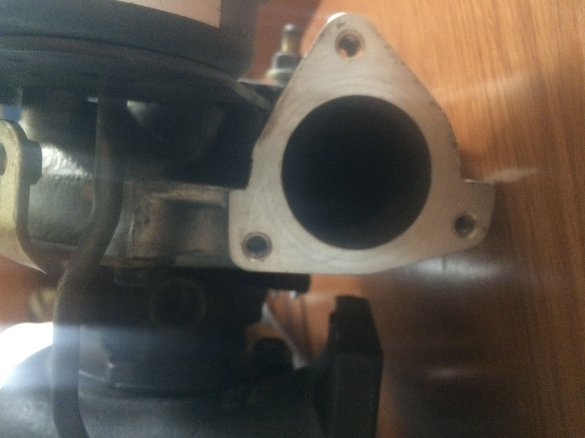

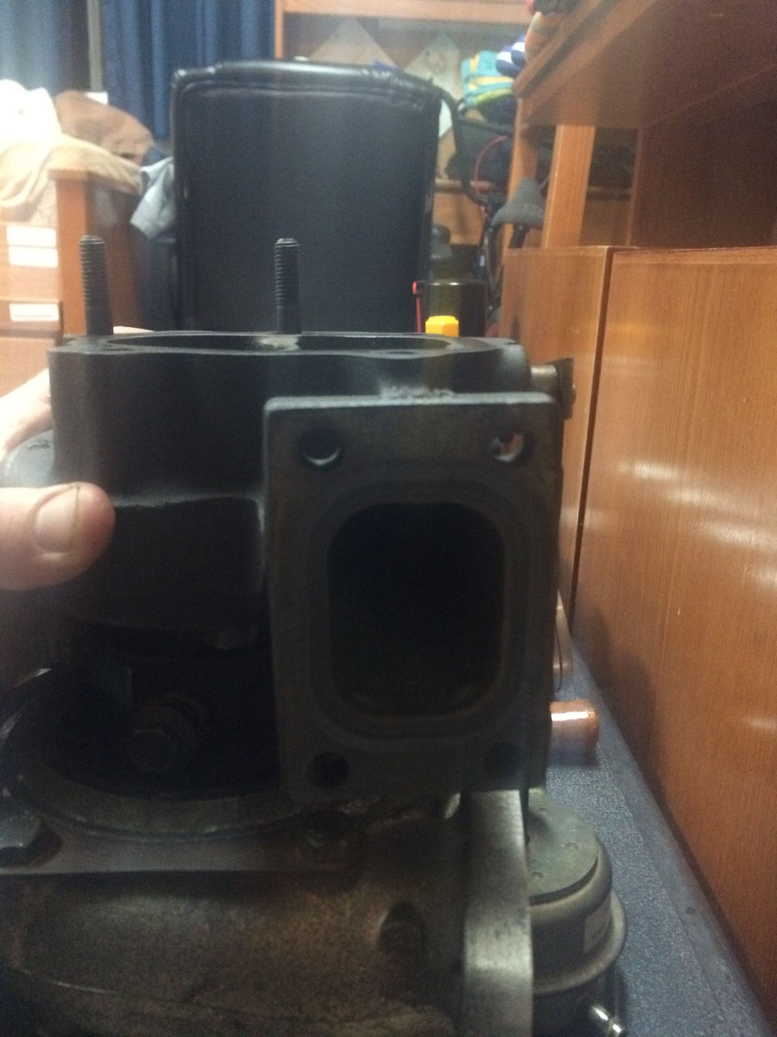

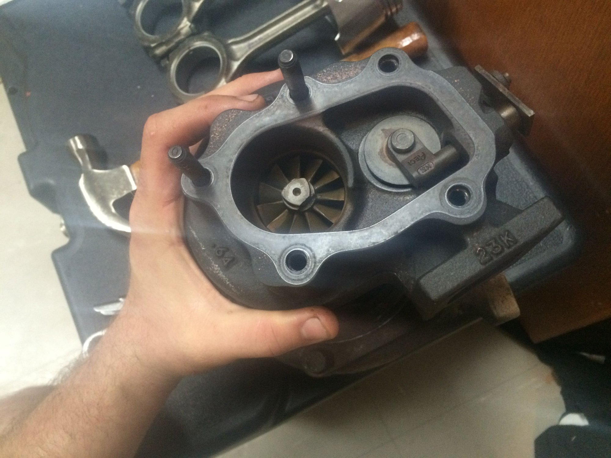

Ah **** my bad here they are

Beautiful shape. I know wantboost has the database for that part number. I have the full specifications of all the S13-S15 Nissan turbos and their efficiencies, so you know how far you can go.

The 75F00 comes back as a pre-facelift S14 (Zenki) journal bearing T28. So basically it's a journal bearing GT2860. Still a solid performing turbo capable of about 320-330hp.
