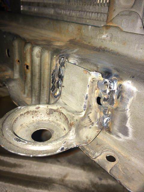

I got the half rad in today. This was my first welding project ever. I'm embarrassed to post my welds but fk it I will anyway. My biggest problem was getting the settings just right. I did 3 cycles of welding and grinding until I got a decent bead. By the way, I had nothing to practice on beforehand either. It was just hard to get a good angle with a mig gun in the bottom of the bay. I stopped for the day because I didn't want to **** off the neighbors but tomorrow I'll grind down the welds and try to get a better bead.

Looks alright man, for a first time welding not bad at all. Everyone's gotta start somewhere I wish I had fab skills/capabilities.

Really not that bad honestly.
Biggest things to keep in mind is clean metal, and being comfortable.

Today I didn't spend anymore time on the lower rad supports. I have less than a month until my tune and need to worry about getting it together in time and not worrying about aesthetics. Function > Form is the name of the game right now. Instead, I started working on my downpipe, which is turning out pretty good so far. I still need to get the lower flange to fit better and to weld a couple 02 bungs, then weld it all up. Right now it's only tack welded together. I also extended the part of my exhaust that has the resonator to make up for the test tube that I removed to make it a true 3". The weld is absolutely terrible on this because it was my first cut on a tube and wasn't a straight cut so there was major gaps that I tried to fill in, just mounding welds upon welds. I just needed to get it mounted so I could work on the downpipe. Still haven't completely decided if I'm going open dump or not yet..

I made sure to wire wheel to a clean surface where the mount was going and the mount itself. Still working on being comfortable.. I swear half the time I forget to switch my helmet from grind to weld. I get flashed then I can't see where I'm welding and screw it up. I'll get there though. By the end of doing the downpipe I was getting pretty good at it, and cutting tube nice and straight.
