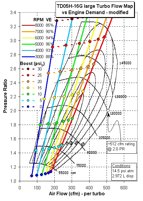

i'm building my hmt kit and looking to use the greddy tdo5h 16g turbo. but what i want to know is where i can get a compressor map and where spooling starts on this turbo if anybody knows? looking to start spooling at ~3300 and not lose power at the top end. will this turbo be good for me? and if not what other turbo's do you recomend?

found it... here it is for anyone else who wants to see one
i'm gonna use the tdo5h 16g but now to another question... is the housing too big even with an a/c compatible manifold to clear the a/c? i'm using slimline fans

There are 2 16Gs. I believe Greddy uses the "big 16G". That is mainly used on their mitsubishi upgrade kits. The 16G is not the same as the 18G.
multiply kg/sec by 132.77 to get lbs/min
Large 16G
Small 16G

ya i'm gonna use the "big 16g"
Old Jul 20, 2007 | 03:47 PM
bigb16's Avatar
Posts: 150
From: Farmington Hill, MI, United States
The "big" 16g is the better choice for sure.

You will definately see boost by that rpm. What are you revving to?

my limiter is ~7.3 so i'll probably only rev to ~6.5
Old Jul 23, 2007 | 03:47 PM
Kyle R's Avatar
Posts: 4,900
From: VA/FL
Default Re: spooling on tdo5h 16g? (94c1v1cex)
My old e3-16g held to 7k no problem.
