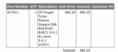

These are the pistons:

It's possible the 160 psi is normal for your pistons and cams, I know there are a lot of variables. Did you have the throttle opened when you tested?

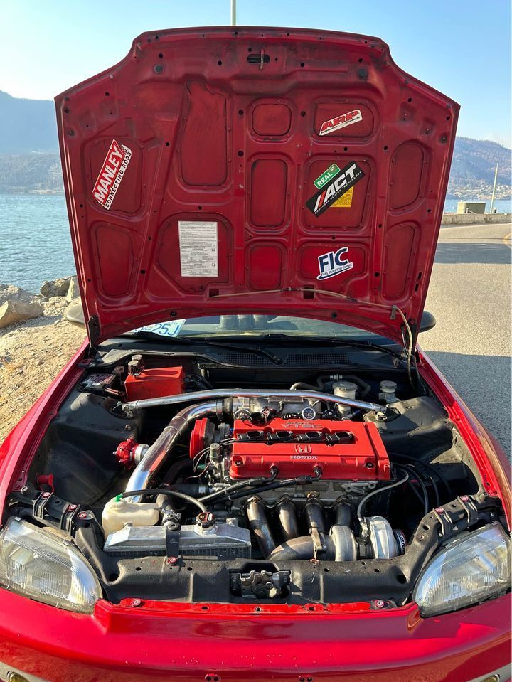

Here is how mine is set up for reference.

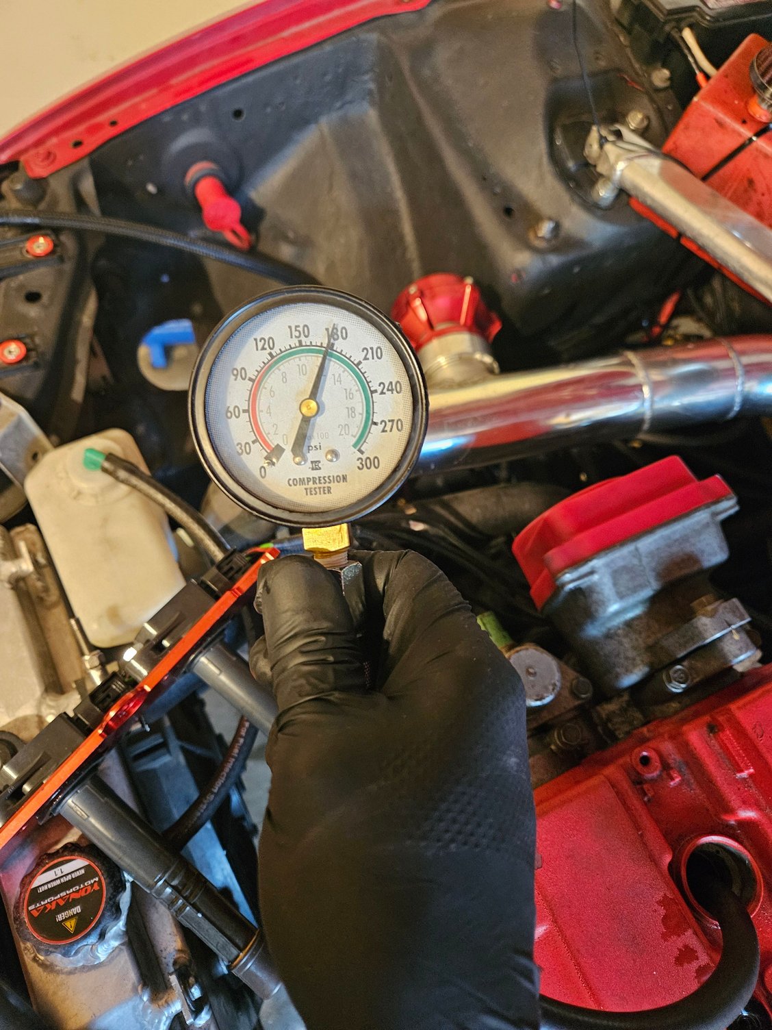

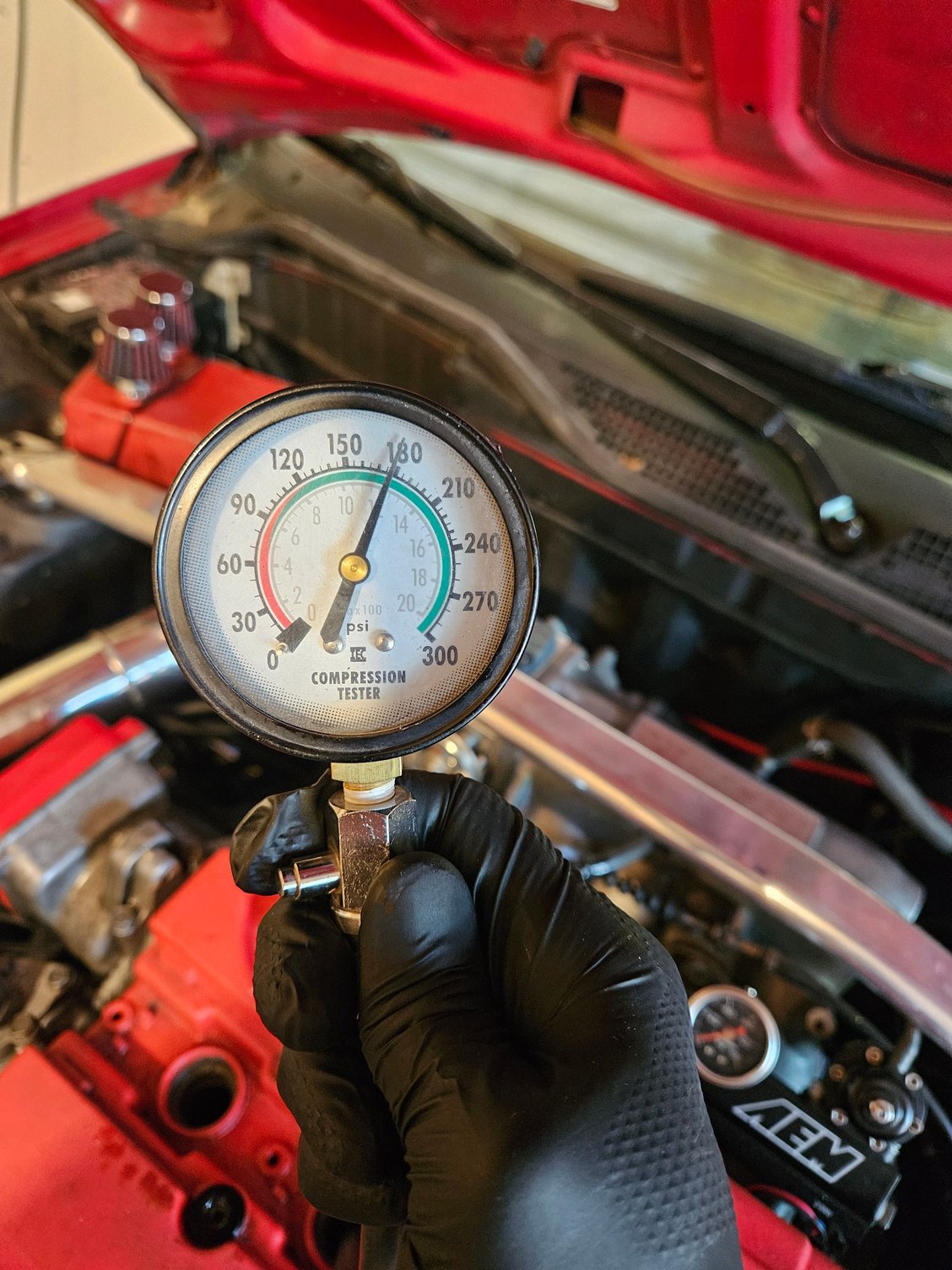

So I think I have some bad news... I did another compression test and because i did it alone, I just held the starter for 5 seconds.
Cylinder 1
Cylinder 2
Cylinder 3
Cylinder 4

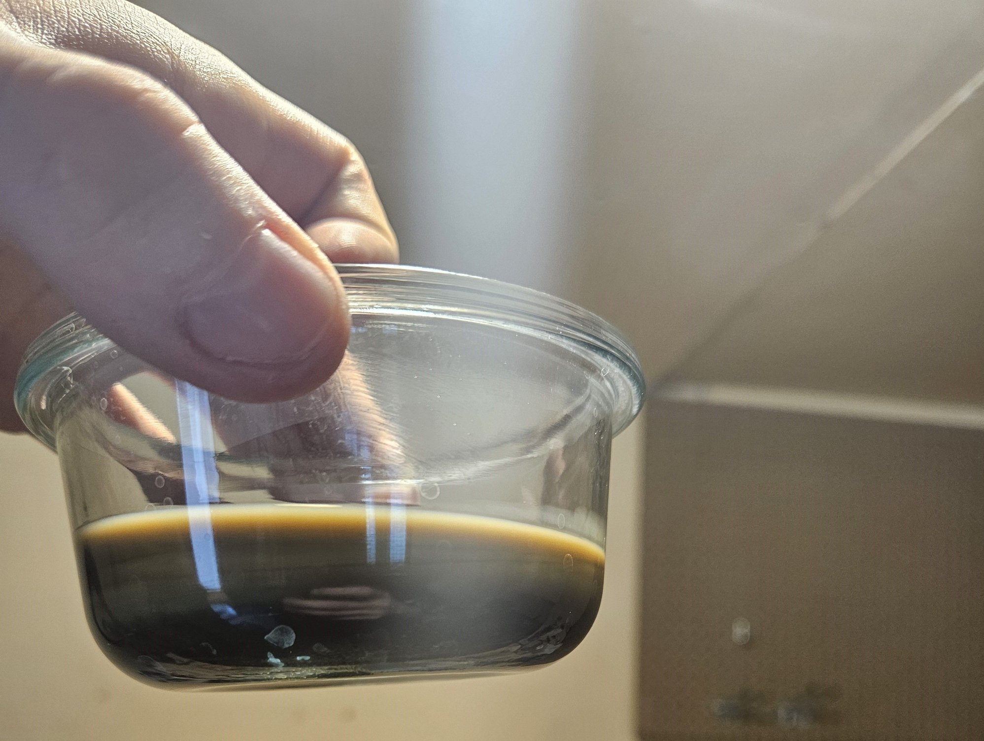

After doing the Compression test I drained out the catch can (which I haven't done yet) and got this
Then I let it idle for about a minute and rev'd it a few times to like 6k and drained this
Soooooo, guess I'm doing a rebuild....

That is somewhat concerning. It's possible there has been some ring wear due to running it without an air filter, or running too rich and washing down the cylinder walls
After testing the last cylinder, did you go back and test the first one over again? Possible that you started getting more compression once there was oil to help seal the rings

I did go back and retest the low cylinders, the pictures I took were actually my second time running through them as I didn't take pictures the first time.
I have a friend coming over later with a cylinder camera to see if we can see anything obviously wrong.
If the walls have no obvious damage, would it most likely be ring wear?
I guess there is a chance that the piston head doesn't quite fit to spec.
