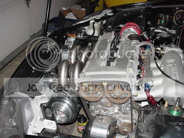

big ol t66!! with this stoker in i want a bigger huffer!
hes a quick pic

<TABLE WIDTH="90%" CELLSPACING=0 CELLPADDING=0 ALIGN=CENTER><TR><TD>Quote, originally posted by earl &raquo;</TD></TR><TR><TD CLASS="quote">the rod to the right is an oem s2000, haha, no comparison can be done.</TD></TR></TABLE>
the real question is this.... how would he confuse an s2k rod for a b20 rod.
also, who's dizzy are you running. that looks like an msd, but it looks nothing like the msd dizzy for the hondas.

<TABLE WIDTH="90%" CELLSPACING=0 CELLPADDING=0 ALIGN=CENTER><TR><TD>Quote, originally posted by wantboost &raquo;</TD></TR><TR><TD CLASS="quote">
i deal with s2000s all day at work and i never bothered to look at the part # on the rod. DOH
accel dfi dual sync
