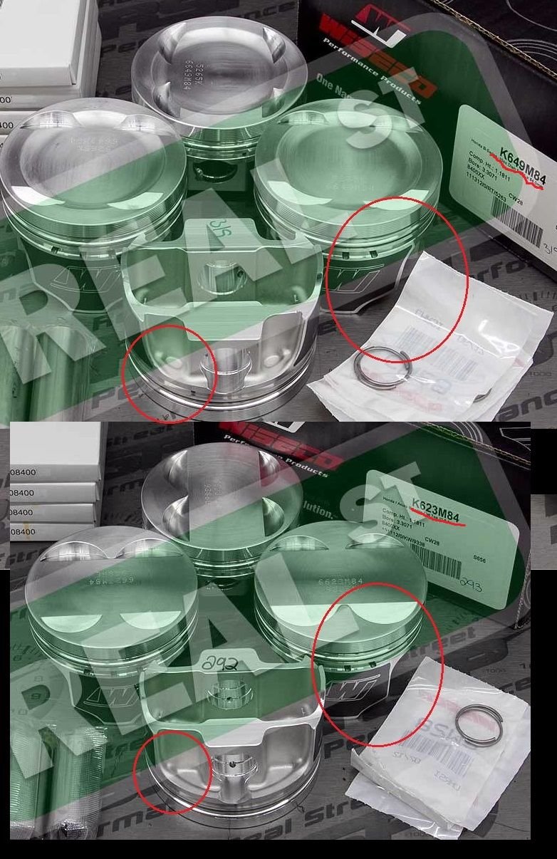

Wiseco K623M84 i really like the price i can get on these pistons BUT im not sure they are so strong. They look bruce lee style. Weighting 296 grams only. Id really like to use these but im not sure they can handle it.
They have narrower skirt from the next piston.Also since these pistons are 10.5:1 on most b18/b20 and 9.5 only on b16 i dont think a lot of people tested them too...Id really like to find results for these...WHO USED THEM ??? :-)
price 550 euros
Wiseco K649M84 These are big *****. Wider skirt from the K623 .The heaviest piston (320g) on the list with longer pin and with the lowest compression ratio.~ 8.5:1. Again i can get a super good s300sxe compressor with crazy efficiency(look below).
Im not afraid to go very low on compression.This piston must probably tank everything. I believe the 0.2 inch wall pin does the job. on both wisecos.

I hope you enjoyed the windows paint edited pictures
