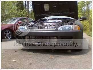

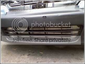

There you go. Properly installed if you ask me.. the driver side piping is way to big, and results in it hitting the bumper. You can cut the fog light holes out, and still it will NOT fit. Another option that would be getting "Creative" would be to cut the piping shoter on the intercooler and the turbo hot side... but why do that when you spend all that money on a somethign that is supposed to fit right? Furthermore, you buy the kit instead of hacking something up, because its bead rolled in order for the charge piping to not pop off under that maad b00st... im interested to hear back from you guys...

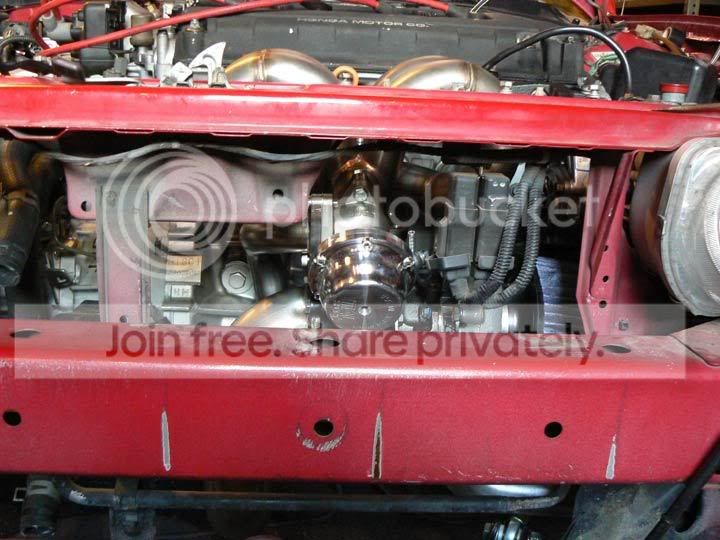

Just curious, what turbo manifold is that? By the angle of the pic it does not look like a PeakBoost FTW or Vers 1 mani. It looks like it is a twisted design like One Fab used to make. If it is a Peakboost, I apologize just going by the pic.

welding a bead is just as good, if not better than a bead roll IMO

Agreed, if you are using the PeakBoost piping with anything other than a PeakBoost manifold or intercooler, it will not be a direct fit..
With the amount of PeakBoost kits out there, there is bound to be an issue at some point or another. Since we've redesigned the charge pipe kit 2 years ago, this is the first we've heard of any fitment issues.

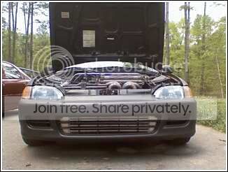

Yea definitely looks to me like your mani places the turbo a lil more towards the drivers side.....
compare it with mine:
