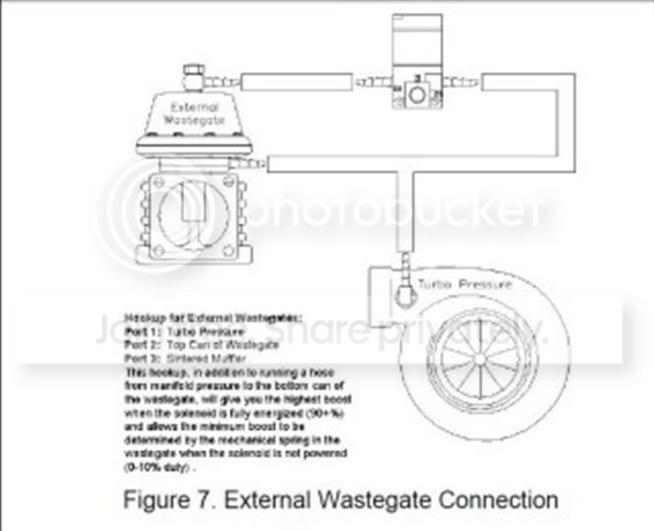

Ok. Well I ran a line from the compressor housing to the gate it picked up some rpm from 6500 to 7300. But still over boosting. Going to let it cool down and pull the gate apart to see if there is an issue itself.
The vacuum line to boost controller is from the intake manifold, then from controller to gate.
Is this your first turbo install?
Are you connecting the pressure line to the right port? All this talk of vacuum...why? A wastegate needs to see pressure, not vac.
Most wastegates have 2 holes, a side one, and a top one. You want a line off the charge pipe before the throttle plate going to the boost controller, then to the side port on the wastegate. NOT off intake manifold.
If you run the line to the top port, you are pressurizing the wastegate to stay closed, overboosting. Pressurize the bottom port to open the gate...
The top port should remain open to atmosphere.

Originally Posted by TheShodan
Huh?
And YES, instead of being at the compressor cover you CAN go off of the intake manifold. If using a boost controller, the top port of the gate IS to be used.
If using an electronic boost control solinoid, you do this.
If using an MBC like OP, you vent the top port, and allow preasure to build in the bottom section of wastegate to open it.
Using an electonic solinoid will vent the top port once a pressure is reached. Thus opening the wastegate because of pressure imbalance. The electronic solinoid has 3 ports, one vents to atmosphere. A nice feature, holding the valve closed juuust until max pressure is reached. Improving spool speed.
With an MBC, a ball and spring reduce the amount of pressure allowed to enter the lower section of the wastegate. The top CANNOT be pressurized, or it just won't open...
Got me?
Got me?
