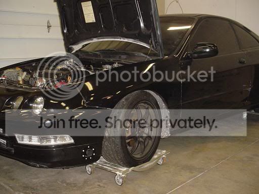

<TABLE WIDTH="90%" CELLSPACING=0 CELLPADDING=0 ALIGN=CENTER><TR><TD>Quote, originally posted by b16hybridsol »</TD></TR><TR><TD CLASS="quote">side exit dump tube on my car, bieetchs!
looks good
im thinking about ditching my filter and throwing a screen on my turbo so I can hear it more over the open wastegate. i love the sound however, id like to quiet it up just a bit and i want to hear the turbo more. plus i hear quite a few guys are running a screen....i just need to get a bit more info on how to mount it on the turbo, etc before i do it.
looks good
