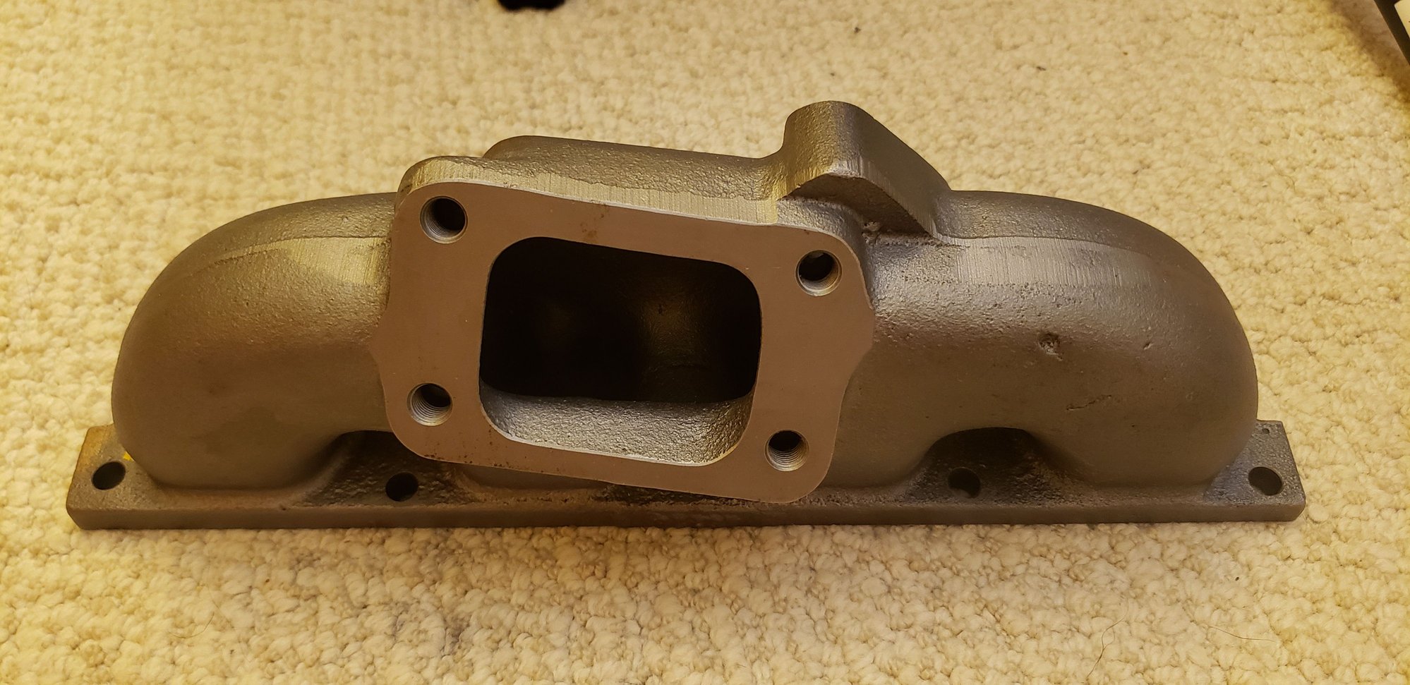

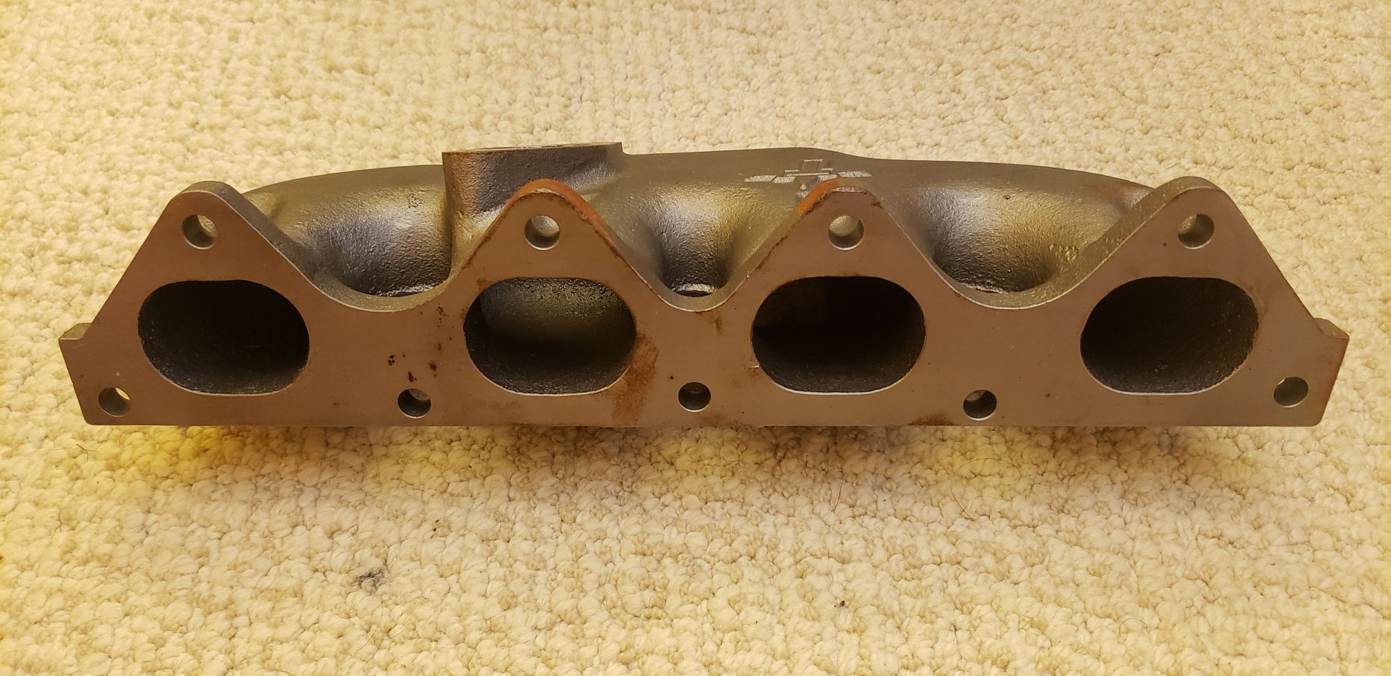

After a month of waiting and constant delays from FedEx, I finally got this in the mail: a new old stock Turbonetics log manifold for the B series. T3 flange and designed to use a 38mm wastegate. I can't find any other examples or documents about this particular manifold design online so I assume its rare. Despite the less than ideal wastegate placement its perfect for my plans and I'm pretty happy with having an old school part. The only thing I've found is that there are holes that lead into the inside of the manifold through two of the mounting stud inserts for the turbo (see pictures) Will this be an issue for me in the future? I'm not sure if things like this will lead to cracks to develop or something else bad. Also, the opening for the wastegate isn't a clean/perfect circle, so should I go through the trouble of cleaning it up or will it work as is? Thanks!

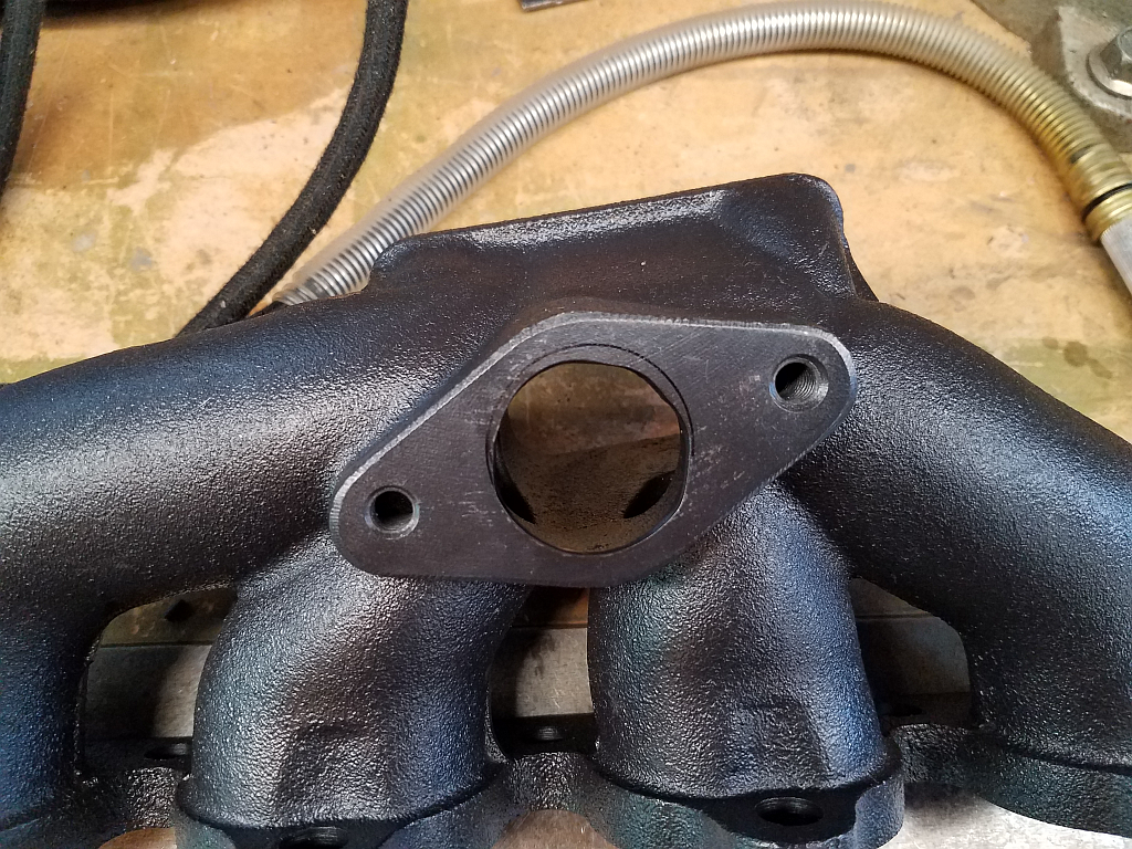

Nice score. I'm sure it will work fine - I wouldn't worry about it cracking, most cast manifolds are pretty strong. The threaded holes breaking through into the inside of the manifold are no big deal. The wastegate opening on my cast manifold wasn't as bad as yours, but wasn't round either. I traced the inside of my wastegate's flange onto my manifold and hand ported it with a dremel and carbide burr to be round. Honestly it probably won't matter, but it bothered me so I fixed it.
Before
After

Good to know! I just wanted to be sure because it is a 20 year old manifold after all and the quality of the cast definitely reflects that... I'll most likely do the same thing you did to clean up the wastegate opening. Thanks!
