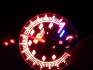

dont mean to jack this thread but i saw no point in making a new topic for a similiar question.
im running a b18c1 with an oil pressure sensor running off of a sandwich plate
im currently untuned on a base map running a precision 5431b and have only revved it to 4500..... This was the peak reading for partial throttle around those revvs.
This seems high right? should i buy a restrictor?
Old Apr 24, 2011 | 04:39 PM
TheShodan's Avatar
Moderator
iTrader: (14)
Joined: Jan 2002
Posts: 24,555
Likes: 242
From: City of Wind, IL, USA
Default Re: oiling system for SC34?
Are you seeing any signs of oil leakage, such as oil in the exhaust, downpipe, or coming out of the compressor? If not, then rock on.

i ran an sc61 last year with the same set up and i didnt have any blue smoke or anything, but when i removed it i did notice a what seemed to be a slight residue when i shined a flashlight in the compressor housing.... is there a downside to running one just in case?
Old Apr 24, 2011 | 05:02 PM
TheShodan's Avatar
Moderator
iTrader: (14)
Joined: Jan 2002
Posts: 24,555
Likes: 242
If you run the wrong size, you could starve the turbocharger. I'd use a .065" if you're worried that much.

Is that a prosport gauge?
Old Apr 24, 2011 | 06:14 PM
LightningTeg's Avatar
Community Builder
Posts: 5,348
Likes: 22
From: Indiana
Looks like glowshift.
Old Apr 24, 2011 | 06:27 PM
hondatuner020's Avatar
Posts: 948
From: NY
correct
Old Apr 24, 2011 | 07:03 PM
Stopsign32v's Avatar
Loved
Joined: Mar 2009
Posts: 1,915
Likes: 109
Are they decent gauges? I was looking at the Prosports
Old Apr 24, 2011 | 09:12 PM
Community Builder
Posts: 5,348
Likes: 22
From: Indiana
They're "ok". I had a set for a couple years in my integra. Felt kinda cheap. I really like how well it matched the integra gauges though.
