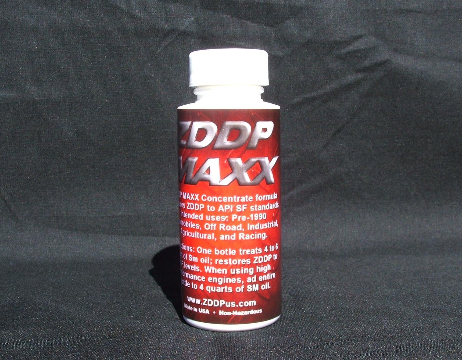

Find an oil you like then add this. It's great stuff and sure does cut down on wear, especially aggressive cam hardware.
