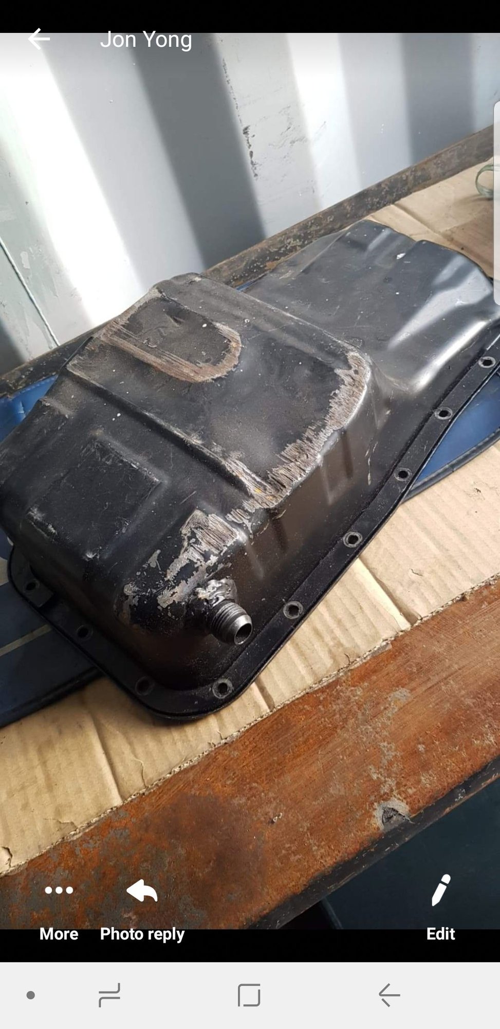

Just about to purchase a b series oil pan and then noticed the bung is pretty damn close to the bottom... my previous builds ive had them tapped closer to the top of the pan.
Any issues with this, or no worries?

Depends on how low, but no it's far from ideal.

I wouldn't run that if it were my car.

Hmm. No way..

Exactly my thought but just wanted to confirm.
thanks.

This is good if u drive a catch can..ive welded one on the top and one in the bottom. Oil catch can return is in the bottom. Turbo return on top.
