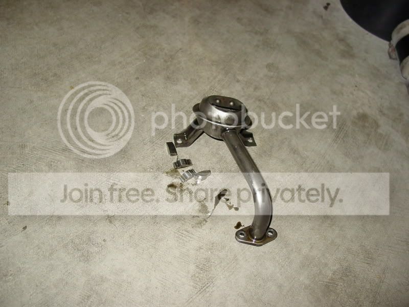

UPDATE
look what i found in the oil pickup
i was in 2nd gear around 8500 switcing to 3rd the oil light came on, popped it in neutral idled for 20 seconds pulled over turned off the car. I let it sit for about 5 minutes cranked it up loud ticking noise, after i had heard the ticking noise i shut it right off. Now did my oil pump shatter?i guess ill just wait untill tomorrow to drain the oil to see if there are any metal shavings in the pan, anyways if thats the case then i will be going 2.0 9:1 comp whole nine yards any help appreciated. Thanks to lawrence and his friends for giving me a tow. any suggestions appreciated thanks as much as i hate dumping money into this car boost is the only thing that keeps me going, it was a fun 11.3 comp on 6 psi

oil pump shattered so hopefuly the bottum end is still good.

thanks for the PM. anyways the pump is what 10 years old motor is a 96 and its been on the same pump since. I didnt misshift i was shifting from 2nd to 3rd then all of a sudden it just happened
