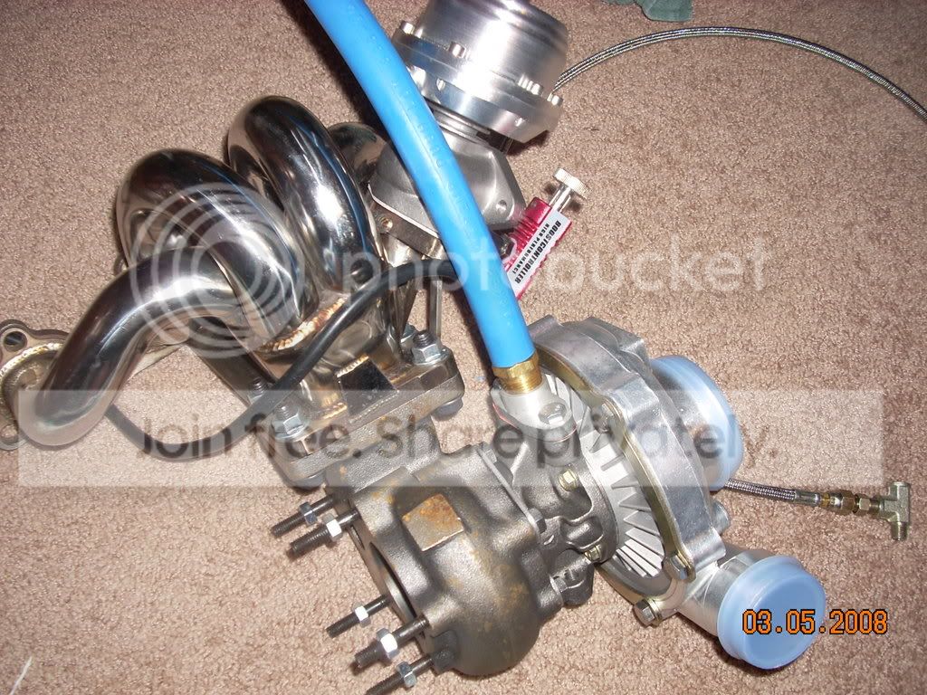

Alright man heres some pics, the blue hose is the one im talkin bout. [IMG][/IMG]

Oh, word. Yeah you can use that blue hose as a return, I don't think its 1.5" though.
Its flipped 180 degrees though, you'll need to rotate the center section on the turbo before you install it.

Is it possible that the oil return flange is just mounted on the inlet? Seems weird that the CHRA would be clocked 180* off. Actually, I guess it would be weird either way
