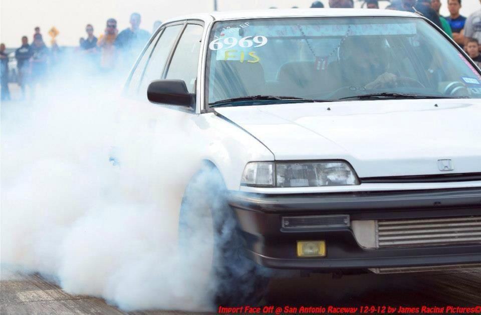

Unless this is going to be a car that is tracked often I'd post this in the turbo forum for the best results. If this is a car that will be hitting the track we can offer more advice. I would not do more than about 300 on the stock block. Reliable 400hp is doable with pistons and rods on stock sleeves.
I daily drove a 300hp 100% stock block turbo b16 for 8 years. Now it's a track only car still running the same block and just now starting to get some blow by from one of the pistons. The engine has been turbo'd since 2005 and in the car since 2002. A good tune and proper cooling makes all the difference in longevity.
