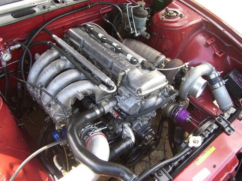

setup:
stock motor/intake manifold (for now)
Exhaust manifold/intercooler pipes/dowpipe made by my good friend Angel (Miami240)
t4/t67
4" downpipe
hks 60mm copy gate
tail 50mm BOV
rc750's
AEM EMS
AEM twinfire
cbr coils
CC twin disk

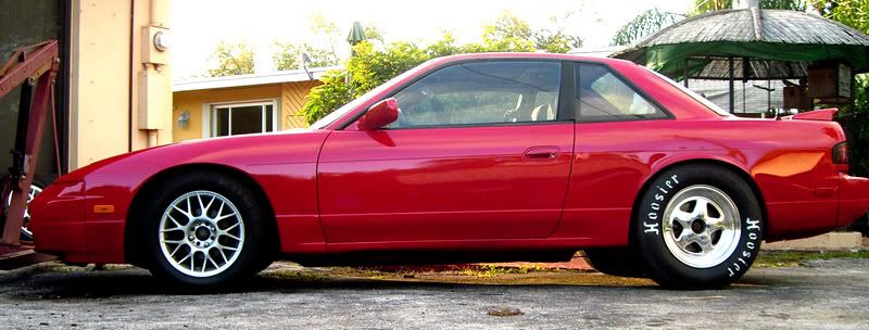

got any shots of the entire car so we can see how it sits with the slick on it?

Looks good! Are the lines fromt he wastegate called the "Muckman lines"?

ill have some up later on

<TABLE WIDTH="90%" CELLSPACING=0 CELLPADDING=0 ALIGN=CENTER><TR><TD>Quote, originally posted by WHTZ &raquo;</TD></TR><TR><TD CLASS="quote">Looks good! Are the lines fromt he wastegate called the "Muckman lines"?</TD></TR></TABLE>
those are quickfit fittings

I love that manifold. Perfect wastegate flow.

Have you started tuning or driving it yet? How is that wastegate holding up?

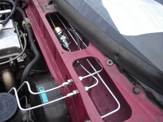

nice liking how you did the brake lines, super clean.

uh, you have the big tires on the wrong end
nice setup

<TABLE WIDTH="90%" CELLSPACING=0 CELLPADDING=0 ALIGN=CENTER><TR><TD>Quote, originally posted by Adi Radoncic &raquo;</TD></TR><TR><TD CLASS="quote">Have you started tuning or driving it yet? How is that wastegate holding up?</TD></TR></TABLE>
the wastegate works awesome, when i first bought it i took it apart and put some high temp grease on the valve and made sure everything was tight. The gate comes with 4 springs, with only the large soft spring in the gate, the car can hold 4 psi till redline ( actually dropped to 3.5 psi) im sure it has to do with the placement of the gate also but so far so good. right now it holds a rock steady 13 psi of boost.

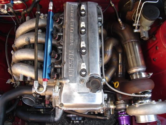

heres a better pic of the manifold
and heres the intake manifold ill be running soon once Angel(miami240) is done with it.
btw this pic of his personal car that used to be ka-t and is now vq-tt

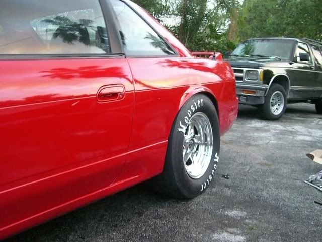

<TABLE WIDTH="90%" CELLSPACING=0 CELLPADDING=0 ALIGN=CENTER><TR><TD>Quote, originally posted by urbansi &raquo;</TD></TR><TR><TD CLASS="quote">got any shots of the entire car so we can see how it sits with the slick on it?</TD></TR></TABLE>
now i just need the front 5 lug and a set of 15x3.5 pro stars to finish off the stance.

Are the runners on the intake manifold tapered? Were they machined from billet? Definitely a nice looking car.

Default Re: My new k series setup... (preludeserge)
yes there tapered and i believe there spun allum.
this pic is from when he was getting started on the mani. they are just sliped into the head flange hence why they arent perfectly straight.
