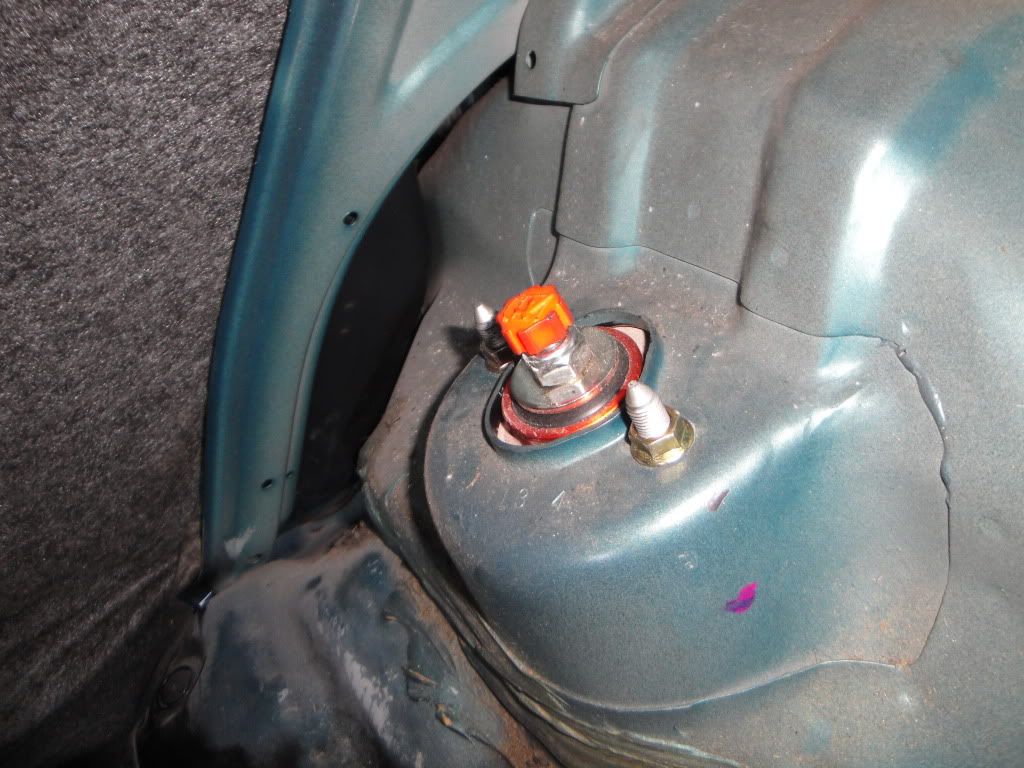

old set up
the car its going in
Traction Bars
Suspension
she is begging for a HEART

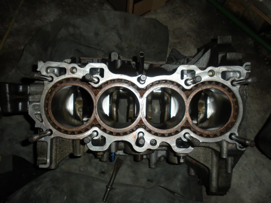

Default Re: My new build setup
GE block gotta bore it to 84 and clean it up
