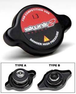

Edit: Skunk2 Sells Type A and B. Type A is what we want for most aftermarket rads and earlier Hondas. Type B is the same style as newer Hondas.

Just ordered the Skunk2 Type A cap. That is what is needed for most aftermarket rads.

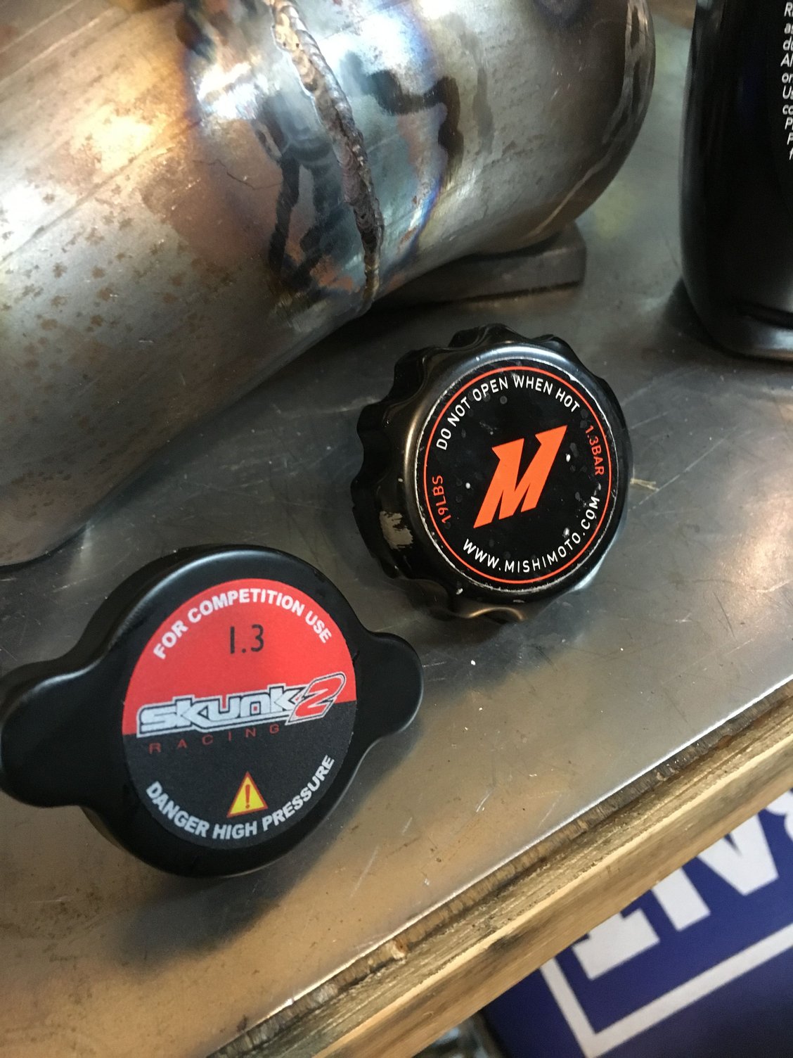

Skunk2 cap fits well and appears to be quality!
