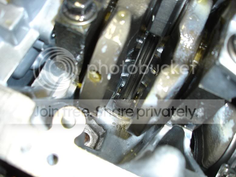

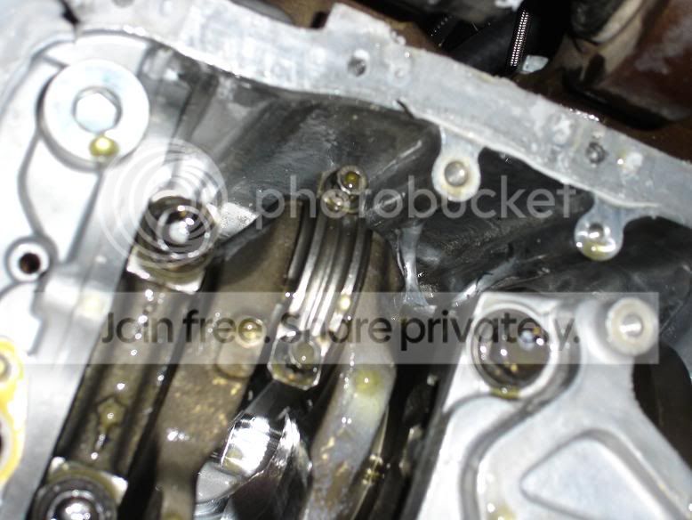

i hat to thread jack, but does anyone have a pic of which eagle rods are which?
These are the only pics i have of mine, wondering which ones they are now...
those look like eagle rods......but it would be hard to just guess without looking at the markings/letterings on the rods.

those look like eagle rods......but it would be hard to just guess without looking at the markings/letterings on the rods.</TD></TR></TABLE>
I think he meant are the 5/16 or 3/8 rod bolts

i know their are eagles, just not sure which ones...

and those rods in the pix above look like 5/16 bolts
