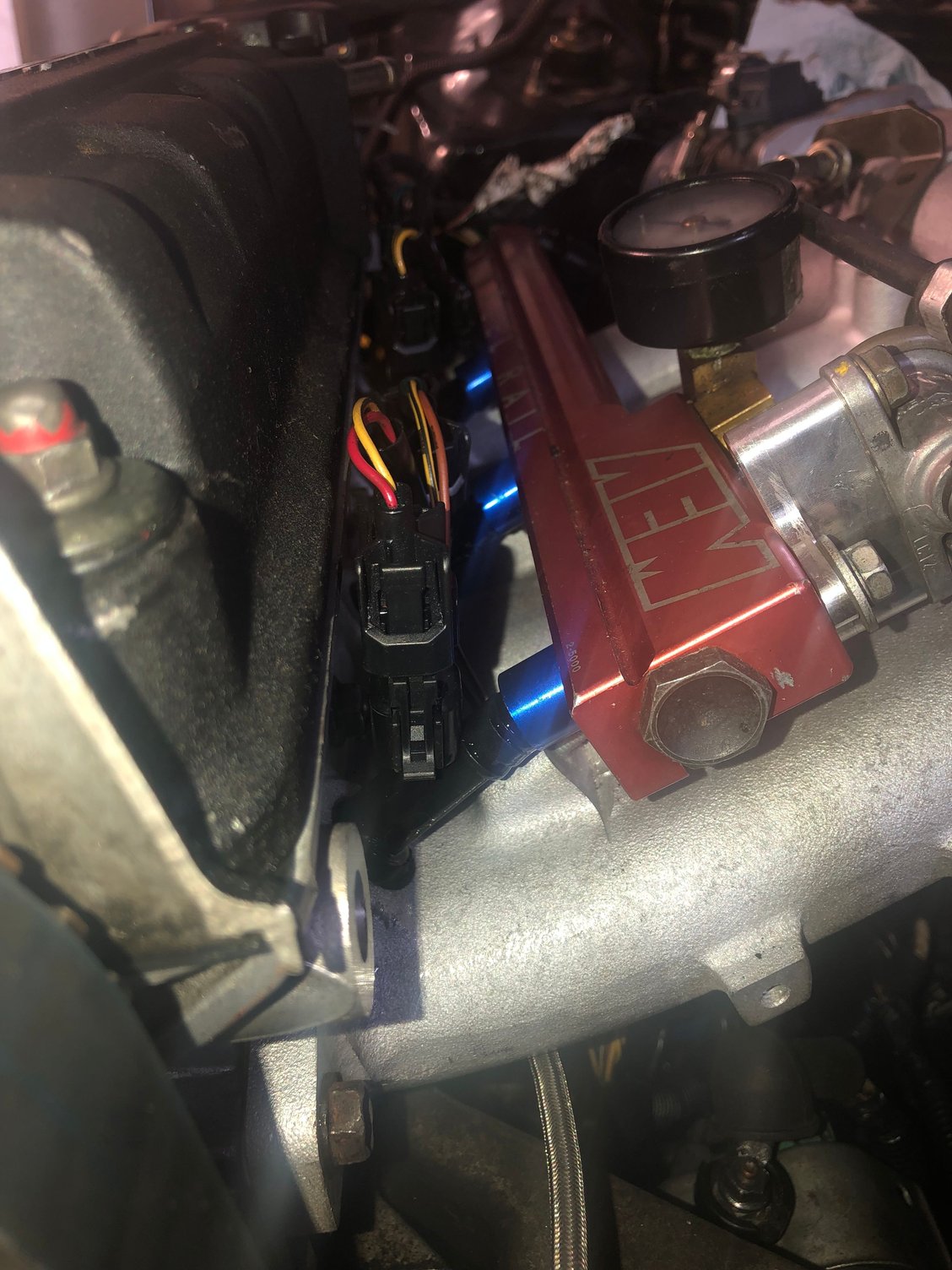

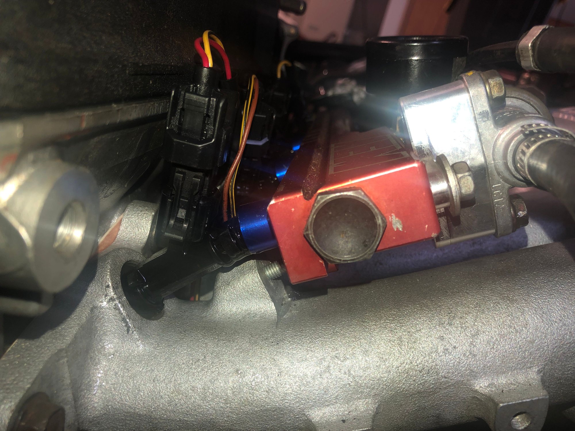

Originally Posted by KiNGDEE206
Idk if you can see the blue top hats it’s kind of angled towards bottom instead of flush
but the bolts bolting down fuel rail may be causing it
i don’t have a spacer before the fuel rail meaning
im>>> NO SPACER >>> fuel rail>>> bolt bolting down fuel rail
how do I attack this problem?
I have the perfect solution for you! I too ran into the same problem when I upgraded my injectors to the tall ID 1,000 cc injectors, I needed something to support the fuel rail and adjust as you tighten down the bolts. I had these springs left over that I never used from a radiator fan I bought. I used 3 springs under the rail and torqued the bolts, as you torque them the spring compresses and adjusts to the height it works perfect! here's a pic of the springs I'm talking about. Build looks good so far!

If you look closely you can see the springs in my pic,

I would use a stack of washers on the mounting studs... and if the studs are not long enough, replace them with either longer ones or use longer bolts instead of studs and nuts. If you use the latter hardware, you can use oil or vaseline to keep the washers together. Also, just an observation: Assuming that your wire colors on your injector plugs are still original, you have them plugged into the wrong fuel injectors. All plugs have a yellow/black positive wire, but the ground coming from the ECU is different for each fuel injector. The color order, from the cam gear end of the engine toward the distributor end will be brown, red, blue, and yellow.

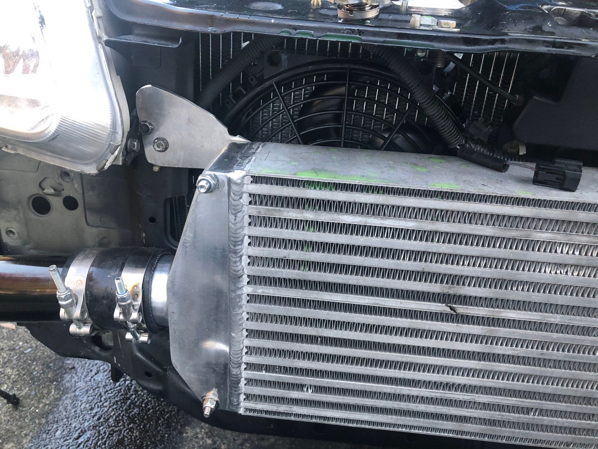

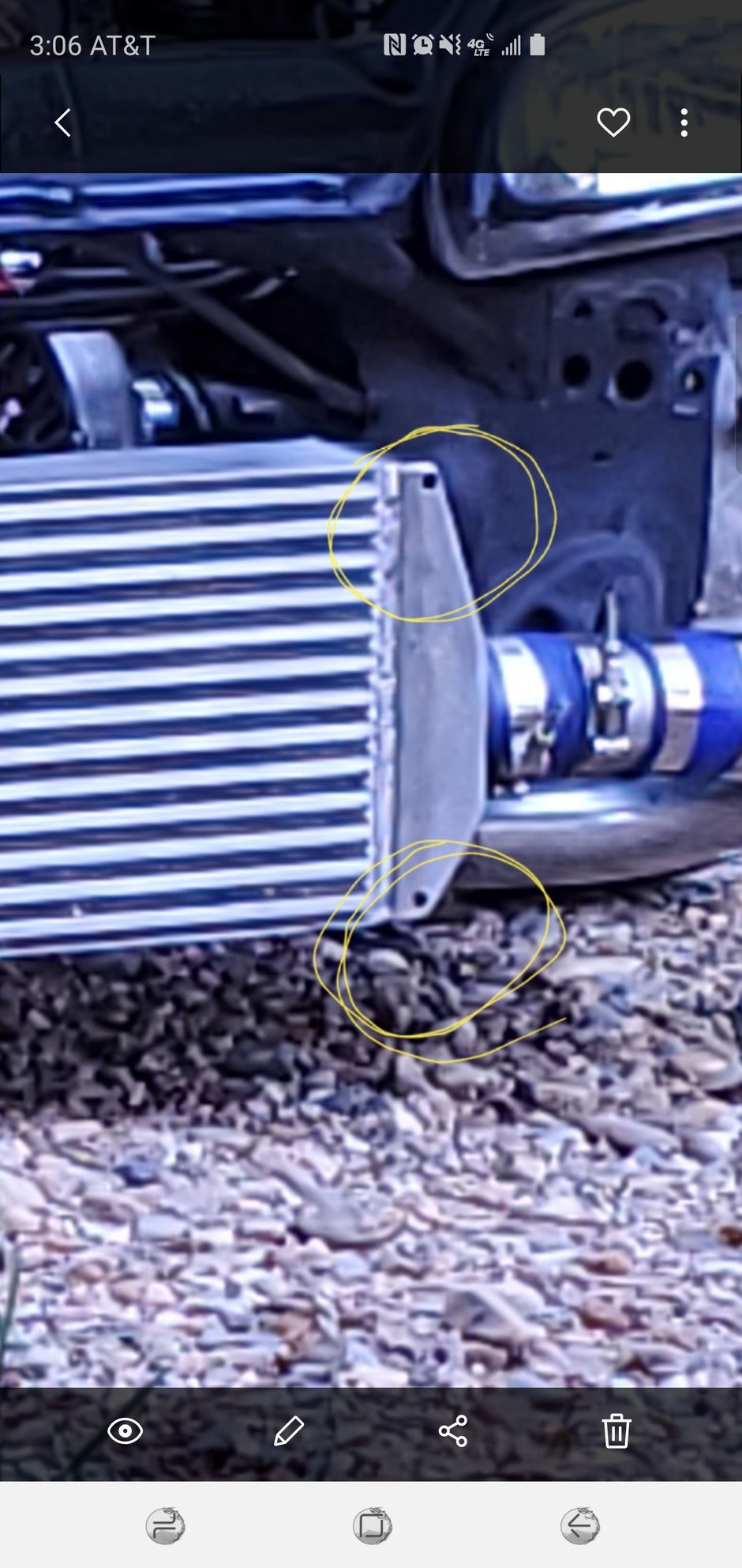

If this were my build I would do something about the intercooler mounting and piping. I would do a backdoor setup on at least the hot side since it looks like the radiator is shifted pretty far over on the passenger side. I would mount the intercooler so that it is solid, not sure if those things hanging are temporary or how you are going to mount it. On the cold side I would have the pipes completely redone and have the blow of valve section all welded in and not use couplers and clamps. I would also use Vanjen quick release clamps wherever possible, they are quick and easy and also help from pressure blowing your pipes off the couplers or faulty clamps.
It's a little cash up front but so badass and easy in the long run.
Agreed, those intercooler mounts dont look up to handle the job. and it seems like it hangs super low to the ground., Wouldnt want it damaged by trash in the road. few others things i notices. The ground on the valve cover looks stretched unless its just the picture. Please run an air filter on the turbo. Please run an actual dump pipe and dont just let it blow like that into the engine bay. And use those fittings on the valve cover and run a catch can. Wouldnt want oil everywhere or potentially causing a fire.

ummmm did you drill holes THROUGH your intercooler to mount it?
pretty sure he didn't.. my Vibrant has them already there in the end tanks specifically for the mount tabs.
ahhh i see, i dont recall ever seeing intercoolers with the holes pre-existing so it just threw me off. pretty smart of vibrant to have them makes life alot easier.
