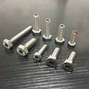

Its probably even worse than it looks.Can you bent the bracket to make its face parallel to the actuator's bottom and use hollow bolts/hollow-threaded as extension with 2 nuts on the bracket to make it stabilise? Or open the actuator and insert longer bolts inside.
Or slash cut - rotate and slice weld
