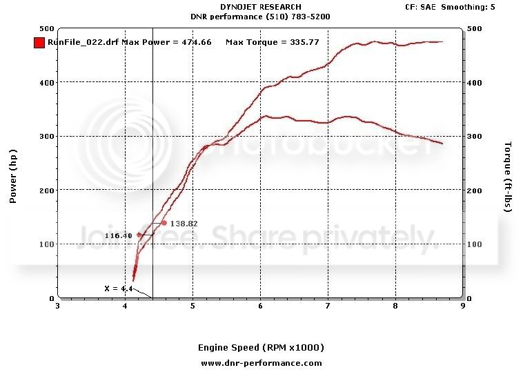

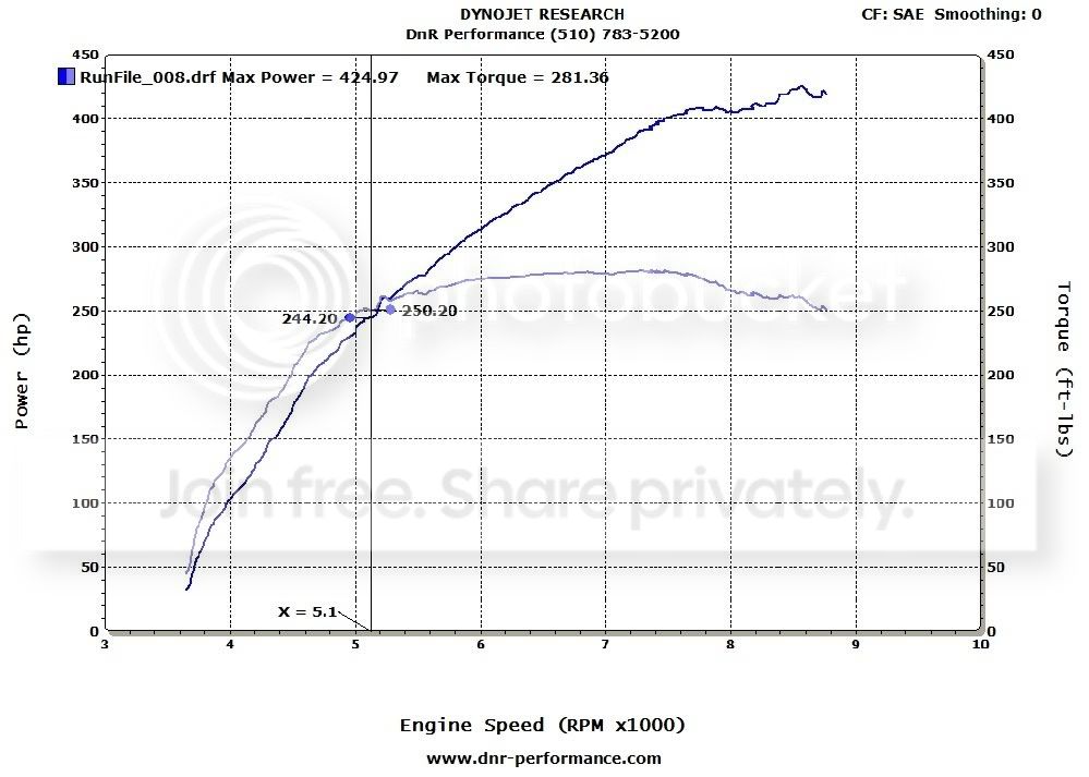

<TABLE WIDTH="90%" CELLSPACING=0 CELLPADDING=0 ALIGN=CENTER><TR><TD>Quote, originally posted by tony413 &raquo;</TD></TR><TR><TD CLASS="quote">champLS and root if you dont mind can you post your torque numbers </TD></TR></TABLE>
Notice the huge jump in torque from the 2 graphs!
112oct
91oct

oh thats very nice now try on C16 but thats a good torque line. depending on your suspension and car weight have fun hitting high 10's

<TABLE WIDTH="90%" CELLSPACING=0 CELLPADDING=0 ALIGN=CENTER><TR><TD>Quote, originally posted by tony413 &raquo;</TD></TR><TR><TD CLASS="quote">oh thats very nice now try on C16 but thats a good torque line. depending on your suspension and car weight have fun hitting high 10's </TD></TR></TABLE>
I'm raising the boost and tuning on c16 next time. I have not weighed the car but its probably over 2700 with me in it. I'm 225! LOL! I should be able to do it with that power with a better 60ft.
