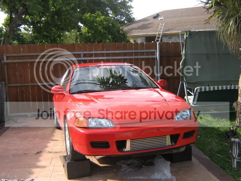

i have a gsr intercooler kit on my turbo b16 92 civic hatchback and let me tell you that it fits but you can see the pipes under the bumper. I dont recomend it at all. Speed bumper and little bumps in roads are my worst enemy.

Default Re: (92redhatch)
Can you post some pics? I'd appreciate it

bottom right you can kind of see it.
damn...that's a lot of pipe sticking out.

it is a lot of pipe sticking out thats why i dont recomend it.
