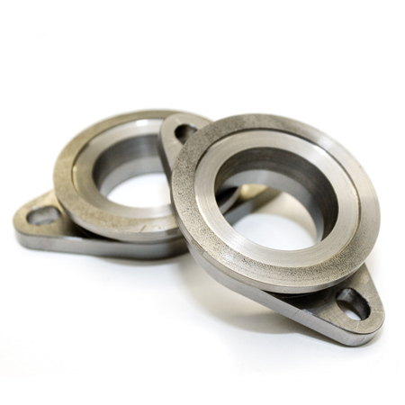

manifold is m10x and wg will not fit an m10

while i have tried researching and found that flange, it yet to answers the question wtf size is this? noone seems to know odd

42mm flange. Came on old innovative 42mm and turbonetics wg. Though they were the same pattern, there was no way to get the wg on, only by using a elbow.

really, how old is this dam manifold then it looked like it was new? i got a 38mm elbow would it seat if i used the gaskets or am i forced to run there 45mm flange with new elbow you think?

dam why the hell would they build that kind of manifold, guess i took dudes word and he was an idiot. so can i use this 38mm elbow or must i get the 45mm and have a new elbow welded? i bought it for the purpose it was 38mm guy told me, thats what i get i guess. and i will not run that ****in 42mm ugly ****ing wg

i have a 38mm gate, but idk if the elbow will mate up to it and not blow the gaskets

http://www.himni-racing.com/images/T...m%20Flange.jpg
ive been told using the 38mm gaskets they wont blow out, but that big a difference is that true?

as i said in your other thread. the wg bolt holes should still be m8 x 1.25. i didnt realize you actually had the big t4 manifold but that still shouldnt effect the wg bolt size.
you might get away with that modded 38mm elbow. or you can get a 45mm flange from inlinepro and have it added to one side of your elbow.

i ended up making a 45to38 flange which is pretty cool, just dont have a gasket for it, i doubt a 38mm gasket will hold but idk

I have the same manifold. I use a emusa 38mm wastegate and the bolt size was a little smaller so i just drill the hole on the wg bigger and put the bolt in. No issue at all. i use the 38mm wg too. I have no boost spike either. but i am using a aem tru-boost.

i run a 38mm gasket. need one so it wont leak.

just bsed with inline pro said no need for one. and ya that was a **** weekend trying to find out wtf this was because dude sold it to me and said 38mm fits right on top. Ya in ****ing fairyland it does. owhell the new adaptor will do just wish i had it hottemped at same time as mani, live you learn
