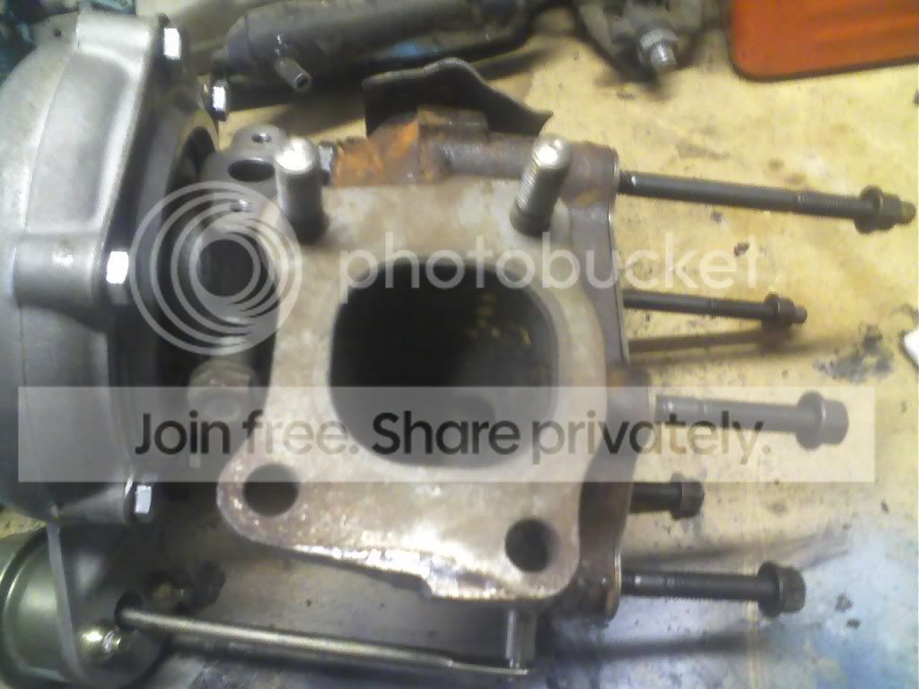

Serial numbers on the chra:
HD0502J
8973105021
700716-12
From searching the serial numbers I found that it is a gt2560... but I cant find this flange to identify it anywhere? Trying to figure out what its from or anything, for whatever reason I cant seem to find something that looks like its right.
ANYONE wanna take a shot at this and help me out?

I was doing some more looking around and definately not a standard GT25/ GT28 flange.

Looks like a TD04-xx from an 850 Volvo, honestly. Volvo has entirely different flanges than the Mitsu's and standard garret stuff. Look around and see if it came off a newer S40 or something.

the volvos have that recession in the turbo inlet if i remember correctly. plus from the picture that turbo looks HUGE to be a volvo turbo.

Not any volvo that I can find pictures of, those are all more like the traditional Td04 flange.

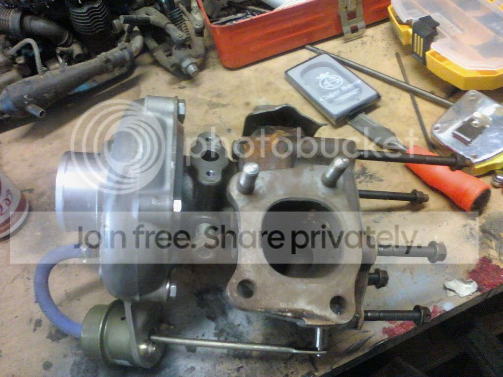

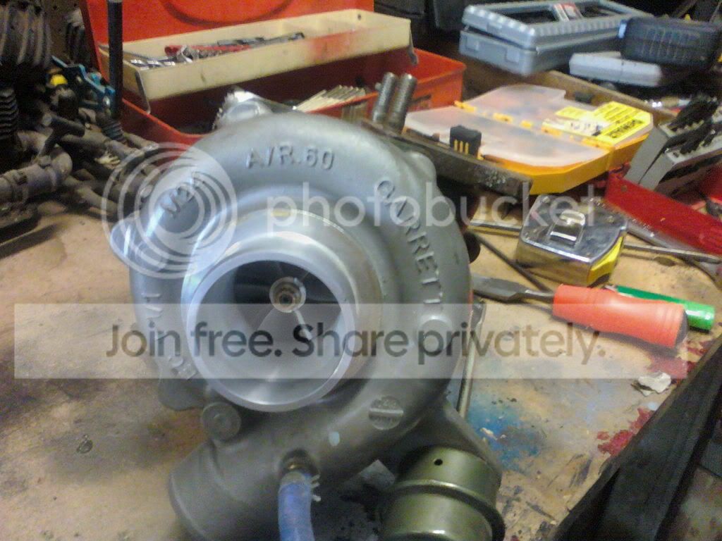

Here is a couple other pictures of it for overall look at it.

def not a volvo turbo thats for sure, volvo has standard t25 flange with the round hole in the middle that is sunk in about 1/16 of an inch
try contacting someone like atp turbo or The shodan on here might know

hi there. i don't know if this is too late but the turbo that you have is out of a chevrolet w4500 or whats called a NPR which is a medium duty box van, usually has a 4 cyl diesel engine. how i know is because i have one in my hand right now that is identical to yours that i just pulled off of a 2005 diesel chevrolet w4500 or NPR . i hope this helped.

Looks very similar to a T25 based GT3071
