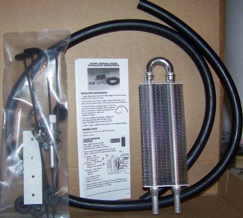

Greetings. I'm not able to find what I want, so I'm asking for advice.
I just paid for the bones of a Prelude JRSC and am contemplating a build list. I'm going to run this setup with the standard 7psi pullies, if I get into the high-13's on street tires I'll be happy. Despite my tuner agreeing with the research I've done in that at stock boost the JRSC doesn't need to be intercooled (Michigan, 93 octane pump gas) to appease my local Hondabro I'm going to look into it.
There is room in the lower intake manifold for an intercooler. If the primary/secondary runners are hogged out like one is building a high-rpm NA manifold one has space for a cooler. I don't want to spend the money on Laminova cores, have diverters fabricated, and welded into the manifold. What I want to do is find a bar and plate IC core and simply carve out a nice square in the lower IM so the core sits flush with the top flange of the LIM. This would functionally replicate the intercooler that ZZP sell for the GM 3800's. However I'm not finding any premade cores that are the correct dimensions.
My best idea currently is to use something rather different; a Hayden brand power steering cooler. They're aluminium and even if not the exact size I need, would either fill enough of the void to be effective or are easily trimmed. They just seem to me to be a little fragile to be trusting in the intake stream. Ultimately this is a luxury to the build and not something I have to have, but if I can implement something without becoming a large portion of the build cost, I'll pursue it. Thank you for the time.

You cannot get enough I/C core INSIDE the JRSC manifold to effectively cool the boosted air charge forever... what you are suggesting will delay the intake temps from rising, but the heat WILL come. As an example, the LHT intercooler upgrade in a "B" series GSR JRSC kit delays the intake temps from rising by 15 to 20 seconds... and then the delta change in temp rises at about 60% the speed of a non-intercooled JRSC.
That trans cooler core that you have pictured has WAY less surface area compared to two 10" long Laminova I/C cores... so what you are considering to use will be even LESS efficient than what I described above. I recommend you get a water/meth injection kit and use that instead. It will be much more effective at keeping the IAT values down.

So, returning to that PS cooler core, what about double stacking them to make an inch and a half thick core? Again, I'm trying to find a bar-and-plate core that's affordable but I'm just spitballing with what I have access to. A pair of Laminova cores the correct length to fit this are going to be over $300
I measured the butterfly spacer gasket out of a partial head gasket kit I have and I'd forgotten how small this is. 190mm or 7-1/2" x 84mm or 3-5/16". This thing is half the length of the plenum on the S2 Pro IM I'd bought for the NA build. 0_0'.

I'm going to agree with JR in that I don't really think you're going to get very good or even measurable results with what you're trying to do with the power steering coolers.

Trust me it looks janky to me too. I just cant find any bar and plate cores that small. I'll read the link though.

I get that you're trying to think outside the box and it is a neat concept but like I said I don't think it's going to be very practical. Like JR said it will simply delay the inevitable. Those JRSCs make crazy amounts of heat.
