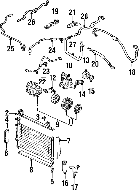

<TABLE WIDTH="90%" CELLSPACING=0 CELLPADDING=0 ALIGN=CENTER><TR><TD>Quote, originally posted by TheShodan &raquo;</TD></TR><TR><TD CLASS="quote">The bolt that holds the A/C pulley on should be tightened only by hand, and not an impact gun, up to (I believe) 15-20ft/lbs (please correct me about the torque if I'm wrong. ) It's a special bolt that has a unique pitch to it. I lost one of those myself.
Well this was the tensioner pulley, not the pulley thats directly attached to the compressor. I am missing parts 14 & 15 from this...but it looks like theres a threaded hole that a bolt came out of to, and I do not see the bolt in this diagram from Sons. I believe it would be a bolt holding part 13 to part 14 or holding part 14 to the compressor?
