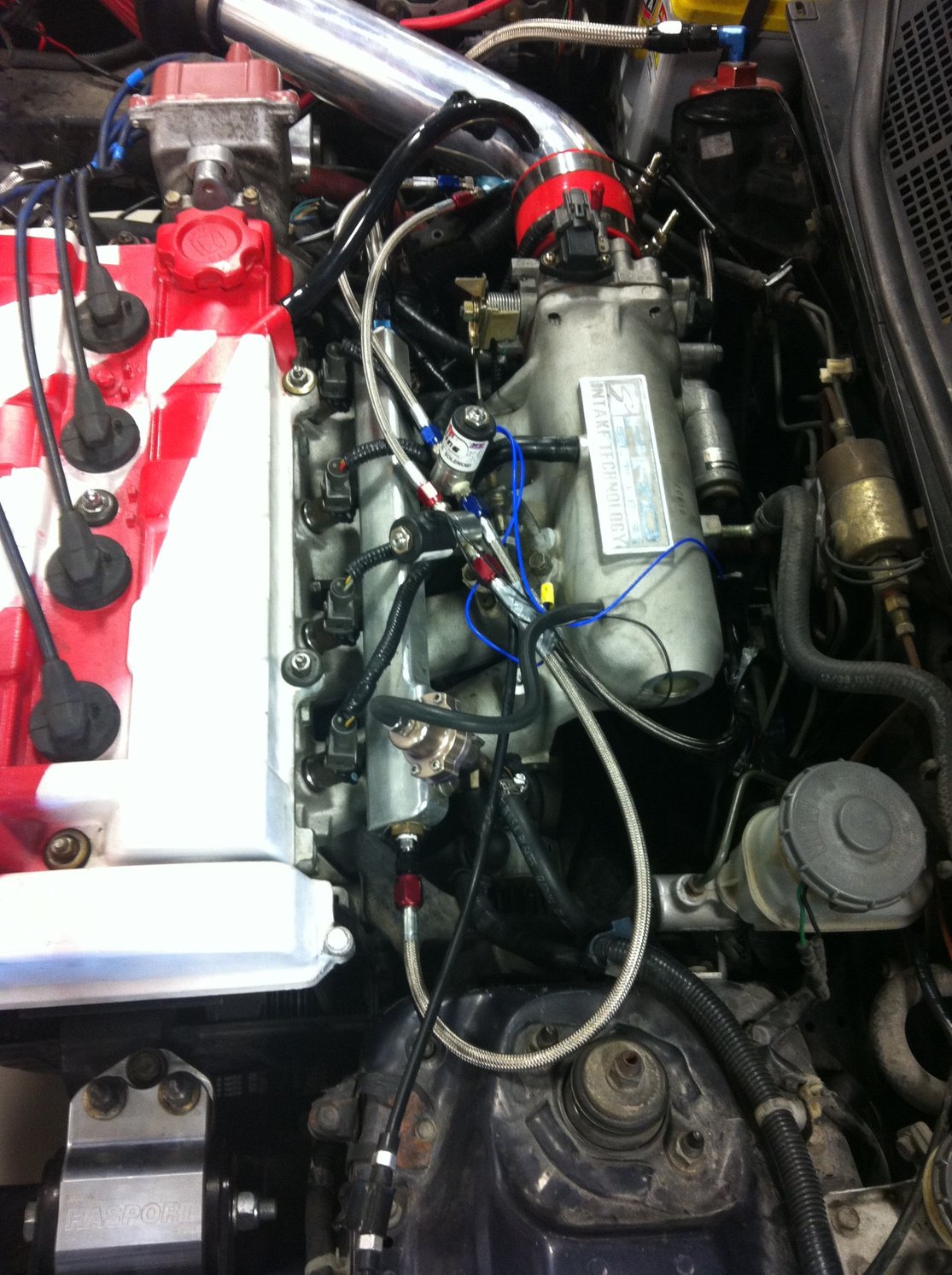

What ^he^ said. I would post a picture of my setup if I had a photo on deck, sadly I am at work but I am using the proton wet kit on my 97 cx hatch. I tapped off the end of an aftermarket fuel rail and ran -4AN off of it, I will see if I can get a picture for you when I get home.

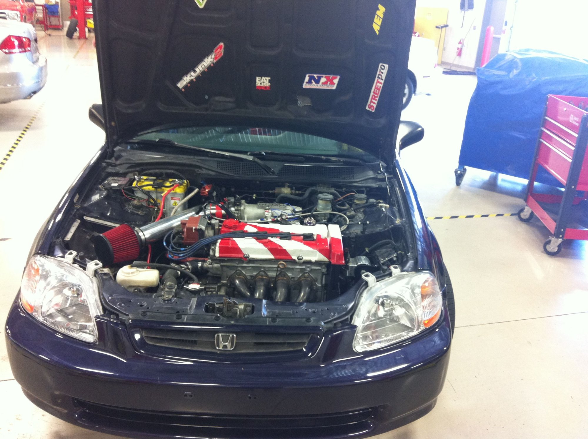

Here you go bud, here is how I ran mine.
