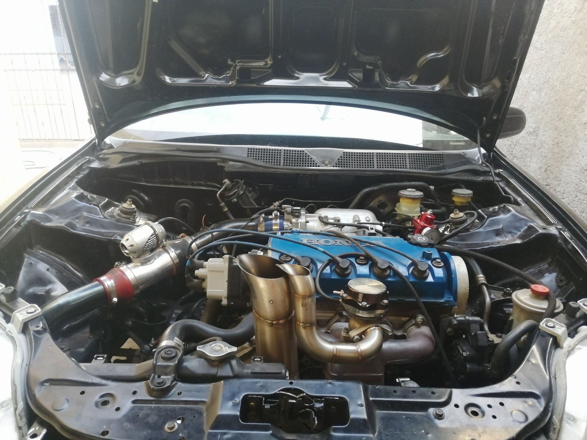

A question, I have a problem with my car, what happens is that when I walk below 6000 rpm the car pulls well, it only goes beyond 6000 rpm, which is when the vtec is activated and starts to throw explosions and no longer move on ... It moved over time and improved a bit a few days, the intake and sensors pull well. I have 50 lbs on the gas regulator and 10 lbs to the turbo with all stock, the car was pulling perfectly days ago
Someone who had the same thing happen and how they solved it..?
