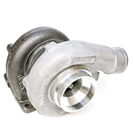

basically I'm trying to remember the name of this turbo that I researched about a year ago. It's a gt25/28 frame turbo with journal bearings rated at 350 whp. going on a stock internals gsr. think its was .54 wheel. was a person selling it in the HT sponsor market but cant find it. been searching for about 2 days now any help appreciated. thanks.

Bump your $600 limit up to get a real turbo either way. $600 doesn't really cut it even for a T3 super 60.
Purpose of the car?
Your cartridge number is 431876-5126
Does it look like this?
Who is Mr Robot?

we need more info on the turbo like pictures of the housings, wheels with the housings removed, and the CHRA. as well as any part numbers on the CHRA tag, if there's one there at all.
without this info we can't tell you what it is
any standard gt28 won't support 350whp. it's rated for crank horsepower and 350hp or roughly 35lb/min won't get you to 350whp. you'll do well to see 280-300whp with the turbo at its absolute operational limit. add in the small turbine wheel and you'll soon find out the turbine wheel is what limits the turbo
Also if it's the turbo me and theshodan think it is then it will have great midrange power but expect to have no top end, as boost will start to fall off in the higher rpm range and thus stopping power production. this is due to the fact you're at the limits of both the turbine and compressor wheels.
it will also require a decent boost level to make 280-300hp. expect 15-18psi at minimum you'll end up at more like 20+psi.
Depending on how good your tuner is, what fuel you use, and the condition of the motor wil all be important factors to consider. you're going to be stressing the stock internals a lot at those pressure ratios on such a small turbo. don't be surprised if you break a ringland, especially if you have low octane shitty gas.
Also we need a complete parts list. what you posted doesn't give us the whole picture and you sure as hell need more parts than that for a turbo setup.

and yea shodan, that was the turbo I was looking for orginally, but I guess it doesnt flow well enuff then for about 300-350 whp? oh and I just went back and looked at the pictures, that turbo is for internal wastegate, need external.

I'd also get rid of that topmount if you're trying to get a responsive "fun" setup. Even that exhaust manifold will take away the "fun" of a smaller turbo setup because of its design was made for higher exhaust VOLUME, not energy.
If you have the fabrication abilities, I'd look to a tubular log manifold or equal length shorty manifold type instead of a topmount or Kooks "Ramhorn" instead.
I'd also use a slightly smaller spring for your precision wastegate, as for the power levels and responsiveness that you're looking for, you'd be overboost for what you need. Unlike 4G63s and 3S-GTEs that like a lot of high boost to get to that level, you'll need less than half that pressure to do what you're asking for due to the cylinder head's volumetric efficiency. Or even better yet, get rid of the Precision altogether and get Turbosmart or TiAL, if at all possible.
Staying Garrett is the right choice, at least, but you'll need to increase your budget slightly. I'd also look at water cooling for a street setup, since you're "stop & go"..

from what you're telling me and what I'm seeing online is that the garrett disco potato with t3 .48 exhaust and external gate.
here's a link to it with the specs:lhttp://www.full-race.com/store/turbo...0rs-turbo.html
my question is now I suppose, should I stay with the .48 or move up to the .63 exhaust?

What you just listed is the Disco Potato in which they switched out the standard internal gate 5 bolt for a T31 4 bolt turbine housing. that turbo is at MAXIMUM about 350whp (so you'd be over 23-26psi of boost pressure to get that level) and that's with the larger .63A/R.
Please remember, you'll be required to get a water line kit (about $125) or so, as well as a .030" restrictor and GT return flanges (which runs about $60) or so.
As wantboost stated:
No one is saying you need anything too big, but at the same time, too small, and yes, you'll get the torqueband you're looking for, but it will not take the top end power you need after about 6000rpms. Even on a "bling factor" topmount manifold. That turbo wasn't constructed that way. If you were a b16 looking to do some road racing on a short course, sure, the Disco would work best, but for what you're trying? with a topmount manifold? Not a good idea at all.
Get your head out of the topmount, (get something more manageable and practical) and you'll need something between 48lbs/min - 50lbs/min for the B18C1 to be effective between 10-15psi of boost pressure.
