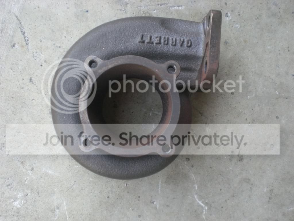

There are 2 Garrett 4 bolts. The standard one is the T31 2.5" 4 bolt housing. Garrett, Precsion, Turbonetics, Comp Turbo, all use this, even for their 3" downpipes.
This is what your more than likely have
The only true 3" 4 bolt is the GT 3", which only comes on GT-R series ball-bearing turbochargers from Garrett
You do not have this: This is what W!d3b0dYr3X was referring to.
3" 4 bolt flange for GT-R series turbocharger only
Standard T3/T4 T31 2.5" 4 bolt flange
