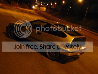

Well I got a 88 CRX with a B16. I got the weight of the car down to 2050 lbs with me in it/ I want to throw out about 240 hp to the wheels. A freind of mine wants me to buy a Garrett GT25. I am having a hard time finding the hotside info on it, but the compressor is a ar 60. Of course it is ball bearinf and it has ben run for a few hours. It also hase been setup for external wastegate and had a extension of the compressor outlet. I am kinda on a budget... and I know it will spool very fast. The motor will be just run off FMU and maybe something to control timing. I want to run between 8-10 psi
What are these worth and what kind of hp number to expect?
And the car it is going on
