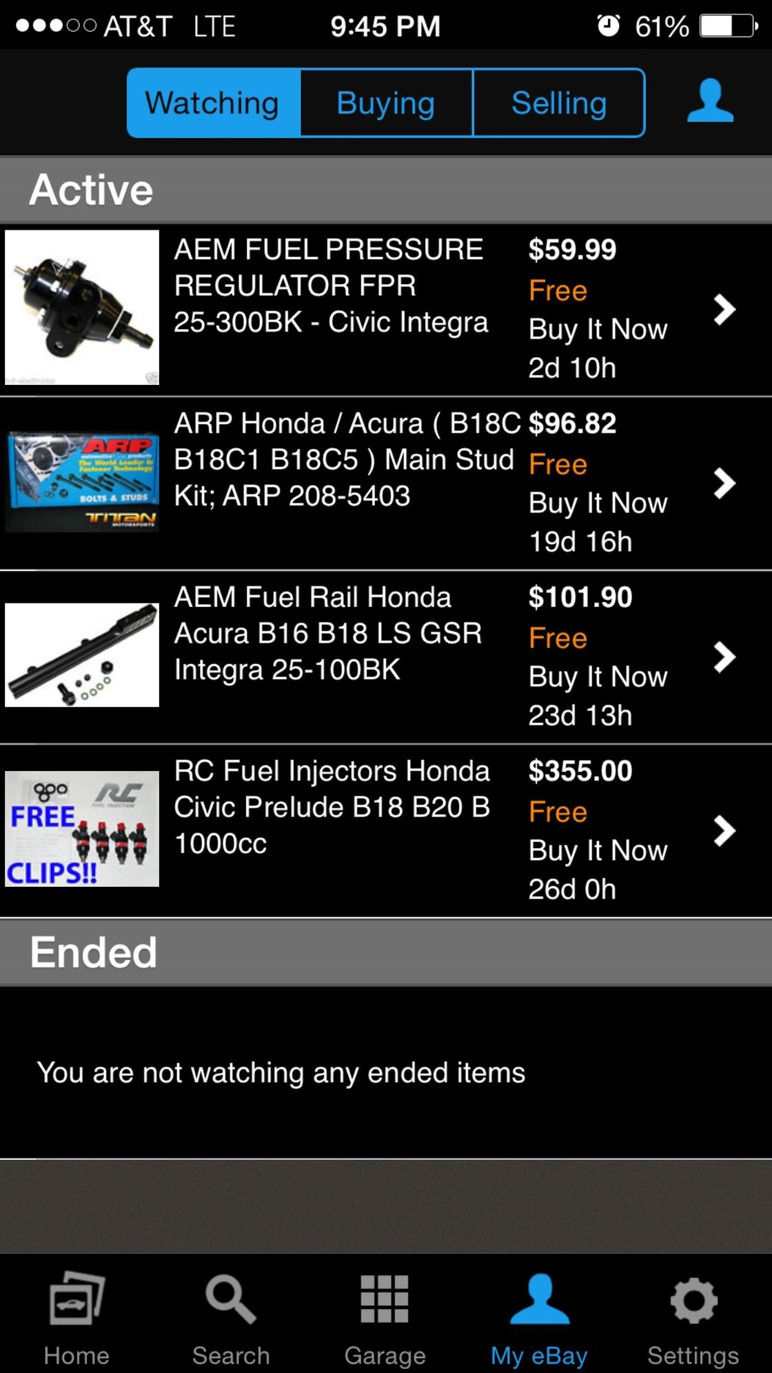

Ok guy new stuff I have for the build
Edelbrock victor x✅
Skunk2 70mm throttle ✅
Hasport mount✅
And this are the next stuff I by buy if u guys would change any of this stuff let me know thank you guys

The rail and FPR are unnecessary for your build - just underhood bling.
And there's a HUGE difference between RC 1000cc (Rochester/Lucas style) Injectors and a 1000cc Bosch-style (Injector Dynamics, Fuel Injector Clinic [FIC]) in terms of use and driveability. The RC 1000cc should be substituted with a for a Bosch-Style injector when you go that high.

Originally Posted by CHU-JDM-DC2
Thank u guys and u say the bosch would flow better then the rc
More efficiently, given the same fuel pressure and its differing spray pattern, yes. Plus, they come in High z with no need for a resistor box. Your RCs will not do that.
Can u please post me a long where I can get bec I when to eBay and I find only one and I don't know if those are the right ones and I was looking a the precision I don't know with one are better
eBay is NOT GOING TO HELP YOU HERE.
Check and research
Injector Dynamics
Grams Injectors
Deutschwerks Injectors
If you can google RC injectors, you can find these companies.
P.S. And for god's sake why a 62-1 for 450whp? You must have gotten that for free or something right? You'll get 450whp alright.... with so much lag you'll get there next week, while an old Fiesta passes you right by.
