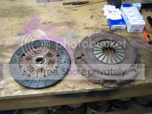

this is my clutch , i would like to know if its good to hold around 350whp on a b18c5....
a guy told me this is a stage3
Theres nothing write on the pressure plate and the disk.

Looks stock to me.

my clutch pedal is harder than a stock one

Looks stock to me too, and I didn't have any luck holding 350+ WHP on an organic disk for any amount of time. I really like the ACT XTR6 for that amount of power though, and it stands up to a lot of abuse.

it looks stock and even if it wasent stock it probably a organic disc stage ibe ckutch which will never hold 350whp
