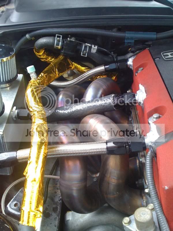

I have a 2002 s2000 on stock block and stock compression. The specs on the setup are:
Full-Race Mani, Charge Piping
T1 downpipe, catch can,turbo intake, all wiring done by t1, and tuned by em
tial 44mm wg and tial 50mm bov
precision gt3076r with .82 a/r
aem ems
precision 1000cc injectors
precision intercooler

The car was running 5.6psi until about 7500 where it starts creeping a little, it's at 8.5psi by 9k. Overall, i was super impressed with the manifold. It's one of the newer FR manifolds with the nice radius on the wg inlet. Keeping boost that low on that motor and turbo with a single 44mm gate is pretty impressive in my opinion.
I've said it a hundred times and eventually people will start to realize it, exhaust backpressure and a crappy manifold kills the S2K motor. You can make a lot of power with a good exhaust manifold on that car.
