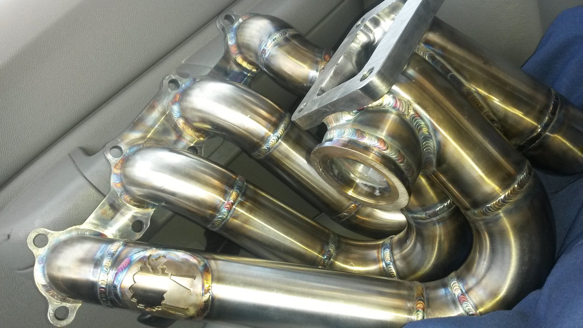

Heres a full race ac ram horn very clean welds inside and out, the pictures don't do it justice was its much cleaner than it looks. I can send you more pics later if you send me a pm.
You might want to base your turbo according for what and how you plan on using it. As far as other companies go I know lighting teg just got one from spooling performance, maybe he could share some pics of the inside

Thank you very much. I do like the looks of the ram-horn. I'm thinking thats the way I want to go. I'll figure it all out slowly but surely. I've got plenty of time. Still considering an inclusive kit. I was looking at the go-autoworks site last night too. They have some very nice set-ups also.
