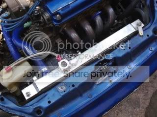

Here is a pic of my motor for refference I own a EM1 so the EK is the same exact thing as far as space goes
Old Feb 2, 2011 | 02:44 PM
LS/V-T's Avatar
Joined: Nov 2010
Posts: 159
Default Re: Full length radiator
Looks like it fit..
