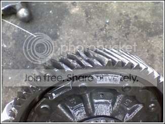

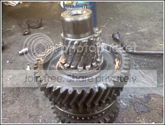

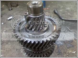

anyone ever done this before?? i dont know if its common or what? i thought it was my diff but after i pulled it apart the diff was fine
carnage pics

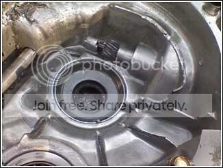

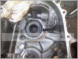

notice pieces of the case missing around the final drive on the trans case

it does happen. what tires/engine/power?

Am I to assume this happened after dumping the dual-plate clutch at high rpm with slicks? I've seen axles snap, but never those gears rip themselves apart, esp in that inconsistent pattern.

the same thing happened to me when we used an ls final drive with a b16 countershaft.

The pin that hold the spider gears shears and the dowel comes out, been through 3 of them. The last one I took apart and welded the spider gear dowel into the carrier. We'll see if this one goes

Doesn't matter, it was the launch that did it. Metal fatigue.
Same deal as when a rod in a boosted setup folds in half at 3000 rpm cruise. People get confused, it happened at 3000 rpms and they weren't even on it??? The rod got a bunch of hairline cracks in it during abusive driving/detonation, but people are mislead that it didn't happen during a pull. The same concept applies here.
FYI, the car I watched bust it's diff did so on 8K launches on 22" slicks. It was scooting pretty well until that happened, 1.7 60' times.

Saying it happened on the launch is naive. It took a lot of abuse over a long period of time to fatigue the metal enough to do that. It's that, or one blunt impact (which the OP said did not happen).

Same thing happened to me, but i was not driving hard at all. I just shifted into 3rd and it exploded the same. The spider gear pin fell out and then it went boom...
