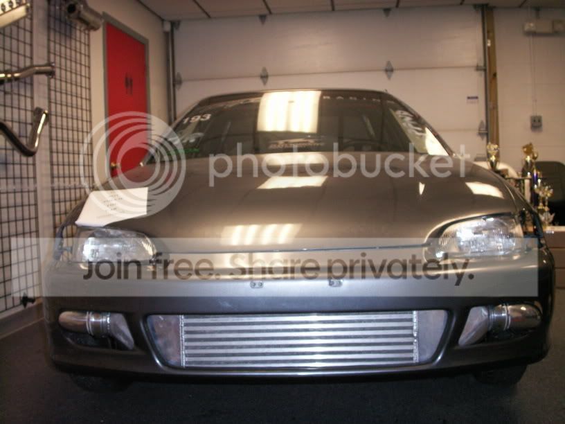

Ok, i talked to Phillip, he wants to run a 24x12x4.5" core, and he has a full race divided top mount with 2 44mm gates. The gates stick out past the core support a little, so fitting a 4.5" thick core would leave you with nothing on the bottom part. So, what he's looking for is a bumper with some more clearance across the bottom lip. Anybody seen anything?

it took me FOREVER to get this to fit like that. i spent a whole hell of a lot of time mounting the intercooler to get it to fit. and as much as i didnt want to do it, i mad to ""modify" my full race manifold to get one of the wastegates to position a little differnt so that the intercooler would fit the way it did. i even went as far as modifying the headlights to position the ic that way.
as far as a 4.5 core....i havnt seen any bumper that sticks out far enough to accept that. i'd think that the core its self would be fine....i'd just imagine the end tank/charpe pipe area would be the problem. could you do a dual back door sorta deal? i guess 4 inch DP woudlnt allow for any movement of the radiator.

Looks like the bottom lip on your bumper is less than 1" deep Joe, is it? If it is, then an inch thicker core wouldn't fly, assuming your ic is back as far as it can go. I can make the tanks fit, just have to come out and back instead of just straight out.
