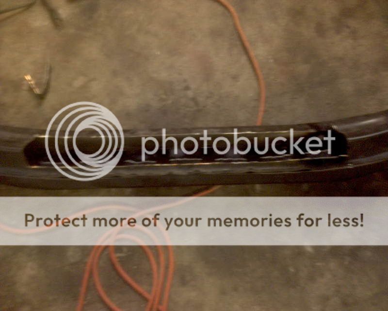

I didn't have to trim any of the plastic part of the bumper. I don't remember what size I got either. I did mine like this:
Leaned it up like this then outlined it with a sharpie.
Before cut:
After:
Mounted

wow, you spent a lot of time, or took a lot of pictures on that mounting. it looks really good tho. Honestly, i just cut my bumper support completely out in the center, to where as though either side of it still bolts to the frame and holds the bumper, but theres nohing in the middle but intercooler. BTW its a precision 750hp
I have a better picture with the bumper off but its on my other comp. It'll be up soon.
Just take the bumper off and see what needs to be cut or drilled for the mouting. Measure 10 times and cut once or do it my way and just cut and cut and cut until it fits. lol

Heres how i mounted mine, i think it was 29x8x3 ebay special... marked out on the bumper support and went at it with a dremel.
Just trimmed the black grill from behind until the bumper fit snug again.
