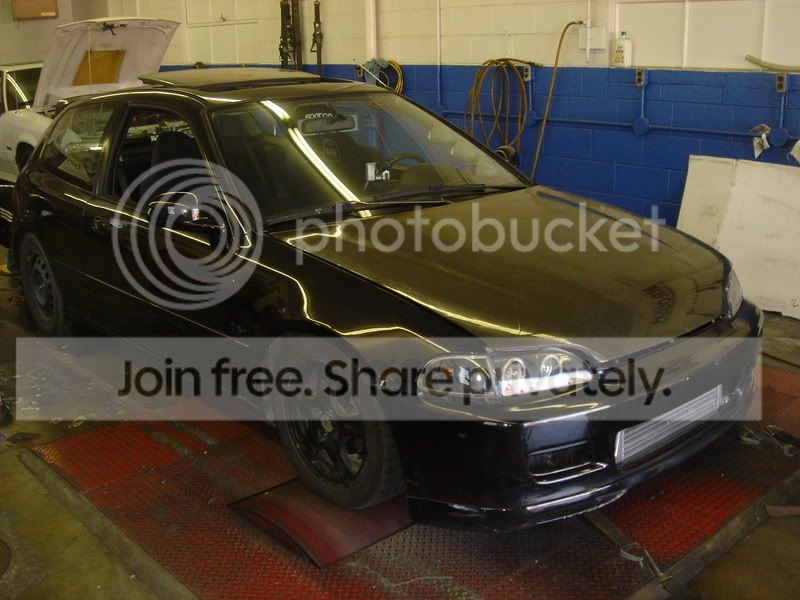

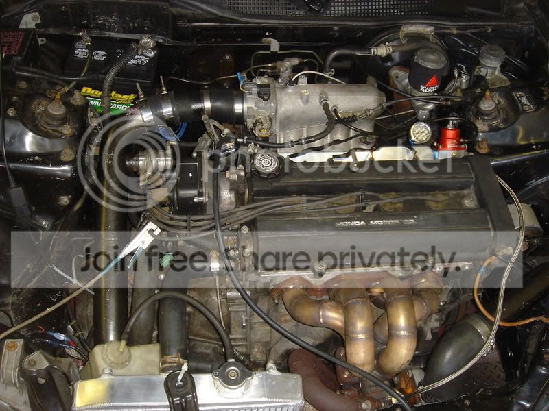

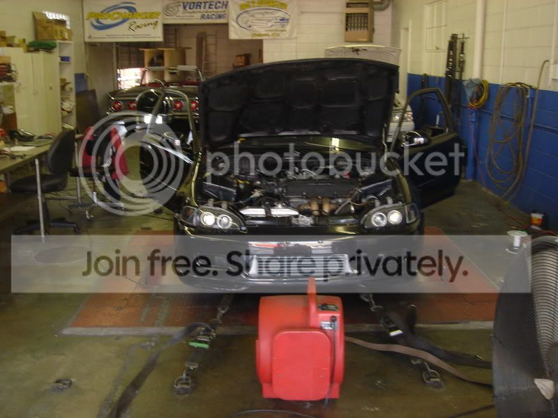

This is my first Turbo car. I'm use to NA, H22 to be specific. But i love boost, still learning stuff. I just got my car dyno'd and tuned. Put down 194HP 173tq on 6.6 pounds seems kinda of weak i think? let me know what you guys think. I have a Sleeved block that I am building this winter. The Head lights and corners are hideous, yes car needs work. I traded for my old hatch. I had to put an ls and slapped this turbo i had on it.

T04E Garret Ar.70, dump tube needs to be re-done.

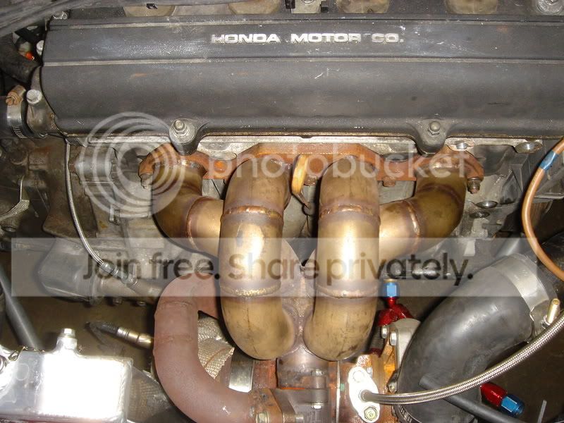

Are you missing two bolts on exhaust manifod on #2 and #3 cylinder?

<TABLE WIDTH="90%" CELLSPACING=0 CELLPADDING=0 ALIGN=CENTER><TR><TD>Quote, originally posted by Turbogixxer &raquo;</TD></TR><TR><TD CLASS="quote">Are you missing two bolts on exhaust manifod on #2 and #3 cylinder?</TD></TR></TABLE>
appears so and if the dump is dumping near the turbo that could really KILL your power

to be honest 1st gear, and all of second spins until third it starts to catch. It pulls pretty REAL strong. Ill try to get a in car and outside view on video...... Yes, the turbo manifold is missing two bolts because of the stupid design. I already decided what i am going to do to fix it. i have to put short studs in the two places. then put slim nuts in it.....

dump it away from the turbo inlet and under the oil pan, basically you want no possibility of the turbo sucking in the hot air being dumped.
