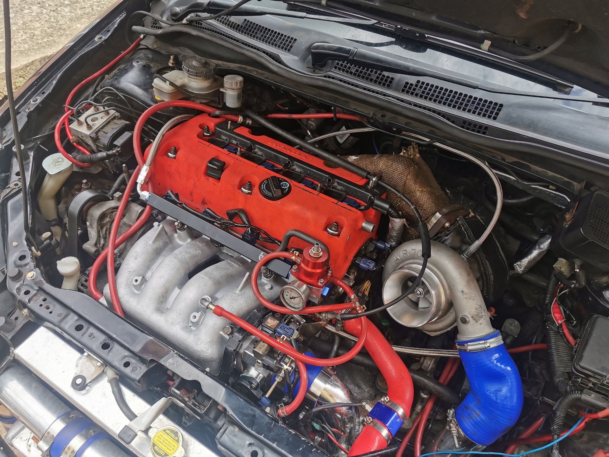

I ran a K20, sidewinder Manifold, GT35 Turbo, with stock internals, 1000cc inj Etc
Plan to rebuild to make more boost and a bigger turbo. Also thinking of going AWD in the future.
